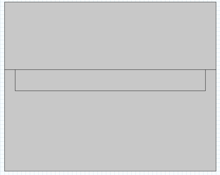

How to calculate the wave's power which pass through an edge before a PML layer?
I am now building a 2D structure which is half-infinite, which I should add a PML layer.
Wave incident to the structure and I would like to calculate how much power it remains after passing through it.
