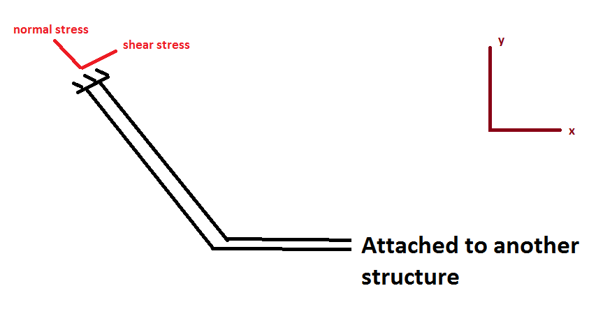

I have a vibrating structure, and using eigenfrequency analysis to get the natural frequency. I want to evaluate the normal stress and shear stress along the clamped edge (please refer to the figure). Since it is inclined from the global x and y direction, I guess the stress transformation equations can be applied to get the normal and shear stress. But, is it possible to do that in COMSOL i.e. evaluate normal and shear stresses at that edge directly? This is a 2D plane stress problem.
Please any help would be appreciated. Thanks.
p.s. please excuse the poor quality of the figure.

But if we turn to the question about how to evaluate stresses in local directions, you should create a coordinate system aligned with the boundary, and then select it in the Linear Elastic node. The local stress results will then be oriented according to this system.

Hi, I completely agree with Ivar in that modal stresses have a very limited usability. But if we turn to the question about how to evaluate stresses in local directions, you should create a coordinate system aligned with the boundary, and then select it in the Linear Elastic node. The local stress results will then be oriented according to this system. Regards, Henrik

I am not really worried by the absolute values, since I would also require the stored energy (J) and put the stresses together in an analytical expression to quantify my required parameter. I guess in the eigenfreqeuncy analysis, the normalization would be same for the stresses and stored energy. My aim is to get the stresses (normal & shear) at the clamped end, and the energy stored in the structure at its resonant mode. These are the two parameters I need to calculate. Energy stored is easy to evaluate from COMSOL. However, the normal and shear stresses , I am finding a bit difficult to interpret from the results.
@Henrik, are suggesting I should create a coordinate system aligned to that edge, and then resolve the problem using that coordinate system? One question though, for example if I evaluate the stresses at the edge (i.e. line average) sx,sy and sxy, are these by default based on the global coordinate system?

Thank you for the replies. I am not really worried by the absolute values, since I would also require the stored energy (J) and put the stresses together in an analytical expression to quantify my required parameter. I guess in the eigenfreqeuncy analysis, the normalization would be same for the stresses and stored energy. My aim is to get the stresses (normal & shear) at the clamped end, and the energy stored in the structure at its resonant mode. These are the two parameters I need to calculate. Energy stored is easy to evaluate from COMSOL. However, the normal and shear stresses , I am finding a bit difficult to interpret from the results. @Henrik, are suggesting I should create a coordinate system aligned to that edge, and then resolve the problem using that coordinate system? One question though, for example if I evaluate the stresses at the edge (i.e. line average) sx,sy and sxy, are these by default based on the global coordinate system? This may be a simple thing to realize, but I don't know why I am finding it difficult :(

You do no need to solve again, it is sufficient to do an 'Update solution' as long as the new coordinate system does not change the solution (i.e. as long as the material is isotropic).
Stress component solid.sx is in the global direction, while solid.Sl11 is in the local direction. See also this thread:

Hi, You do no need to solve again, it is sufficient to do an 'Update solution' as long as the new coordinate system does not change the solution (i.e. as long as the material is isotropic). Stress component solid.sx is in the global direction, while solid.Sl11 is in the local direction. See also this thread: https://www.comsol.com/community/forums/general/thread/34639 Regards, Henrik
