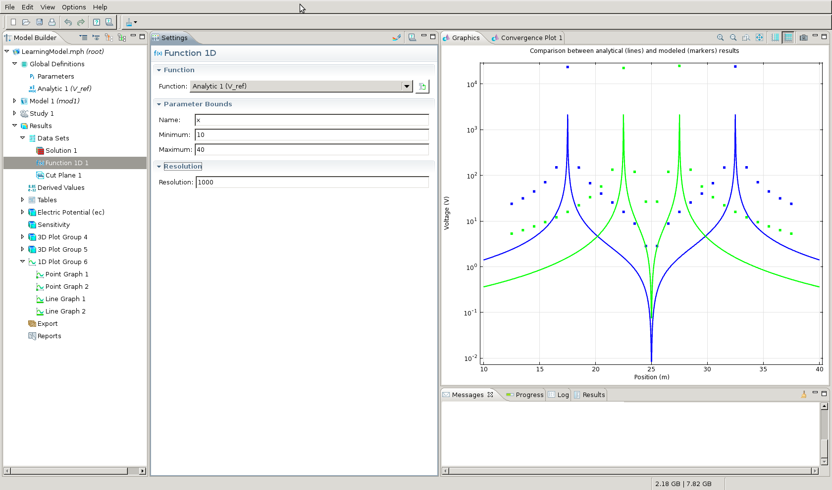

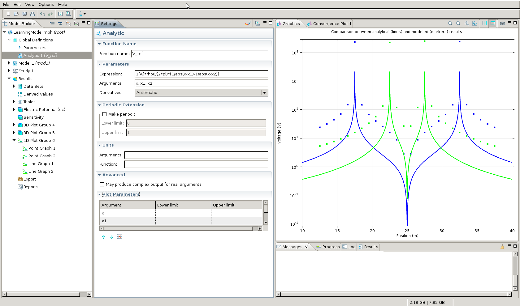

1. How I defined the analytical solution (1.png): V = 1[A]*rho0/(2*pi)*(1/abs(x-x1)-1/abs(x-x2))
Does the error lie here? Do I somehow have to tell COMSOL what the units of the arguments x, x1 and x2 are?

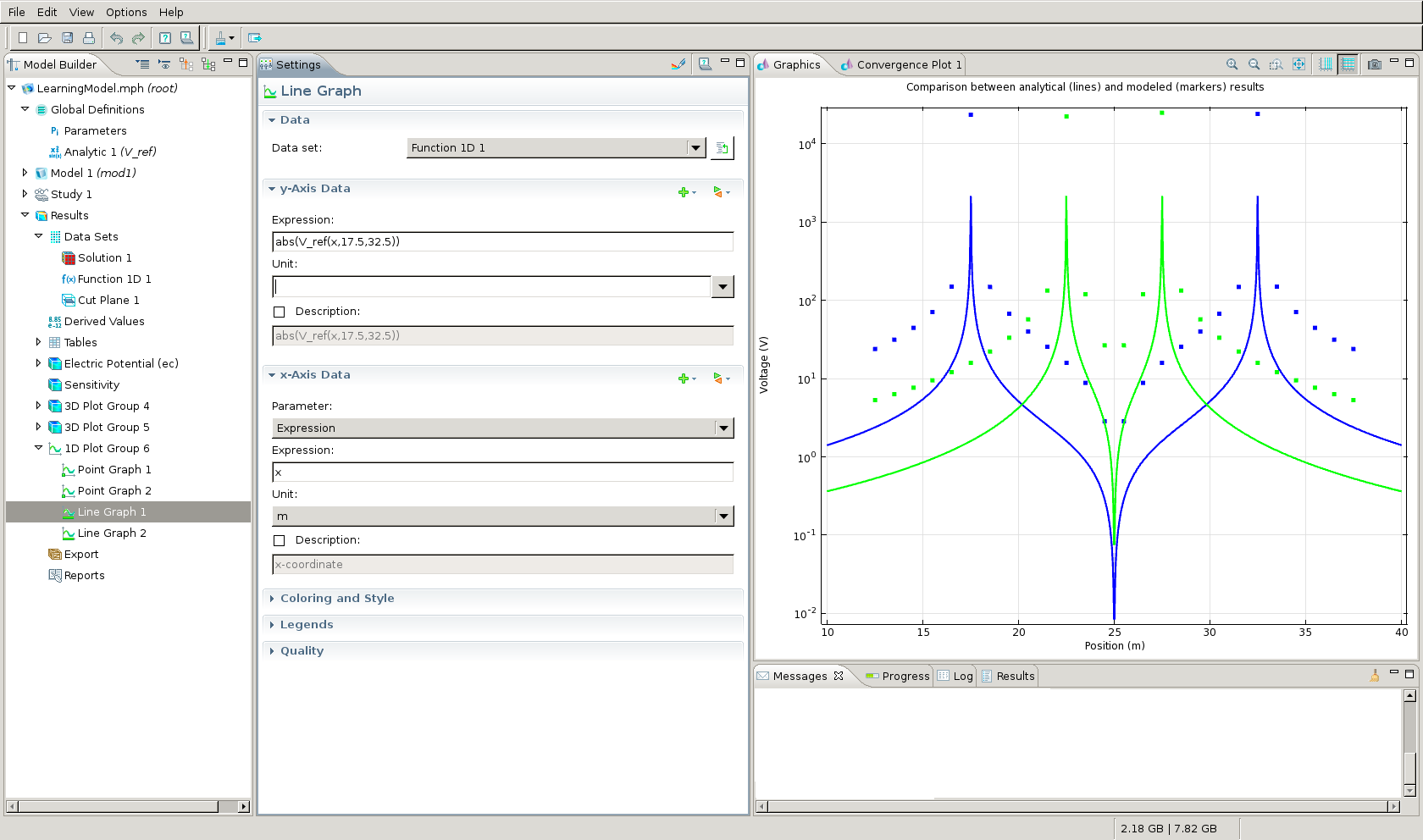

2. How I added the function to the data set (2.png): This should be okay.
3. How I tried to plot it in a 1D Line graph (3.png): Here I cannot choose a Unit. But strangely, if I put the Unit "dV" (as it is in the point
graph 1 for the calculated solution (dots)) and press "Plot" the line is correct but the "dV" is deleted and if I try to do this for both line graphs it doesn't work as the dV always gets deleted as a Unit...
So the question is: How do I get this correct in a way that I can choose the right Unit in step 3?
