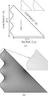

THANK YOU SO MUCH!!! CAN I MODEL A TRIANGULAR ENCLOSURE(fig attached) By this same method?
Posted: 9 years ago 2016/05/23 15:02 GMT-4
Of course, just replace polygon with an open triangle.
Br
Lasse
Of course, just replace polygon with an open triangle. Br Lasse
