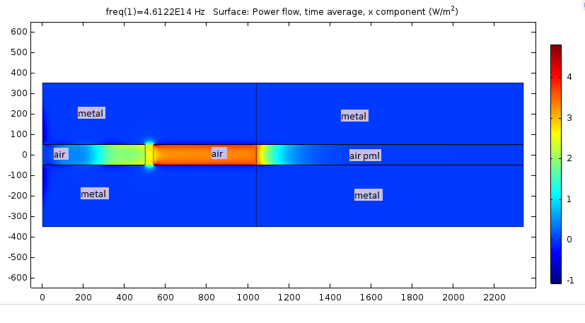

hi everyone,
i have simulated MIM wave guide (air, gold) at wavelength 650nm using Comsol 5.2. coupling between 2 wave guides which are placed at a distance of 20nm is expected. SPP is propagating from left to right, but power in x direction as plotted shows max. power on right wave guide. is this result correct? if so what is the reason?
can any one help me?
