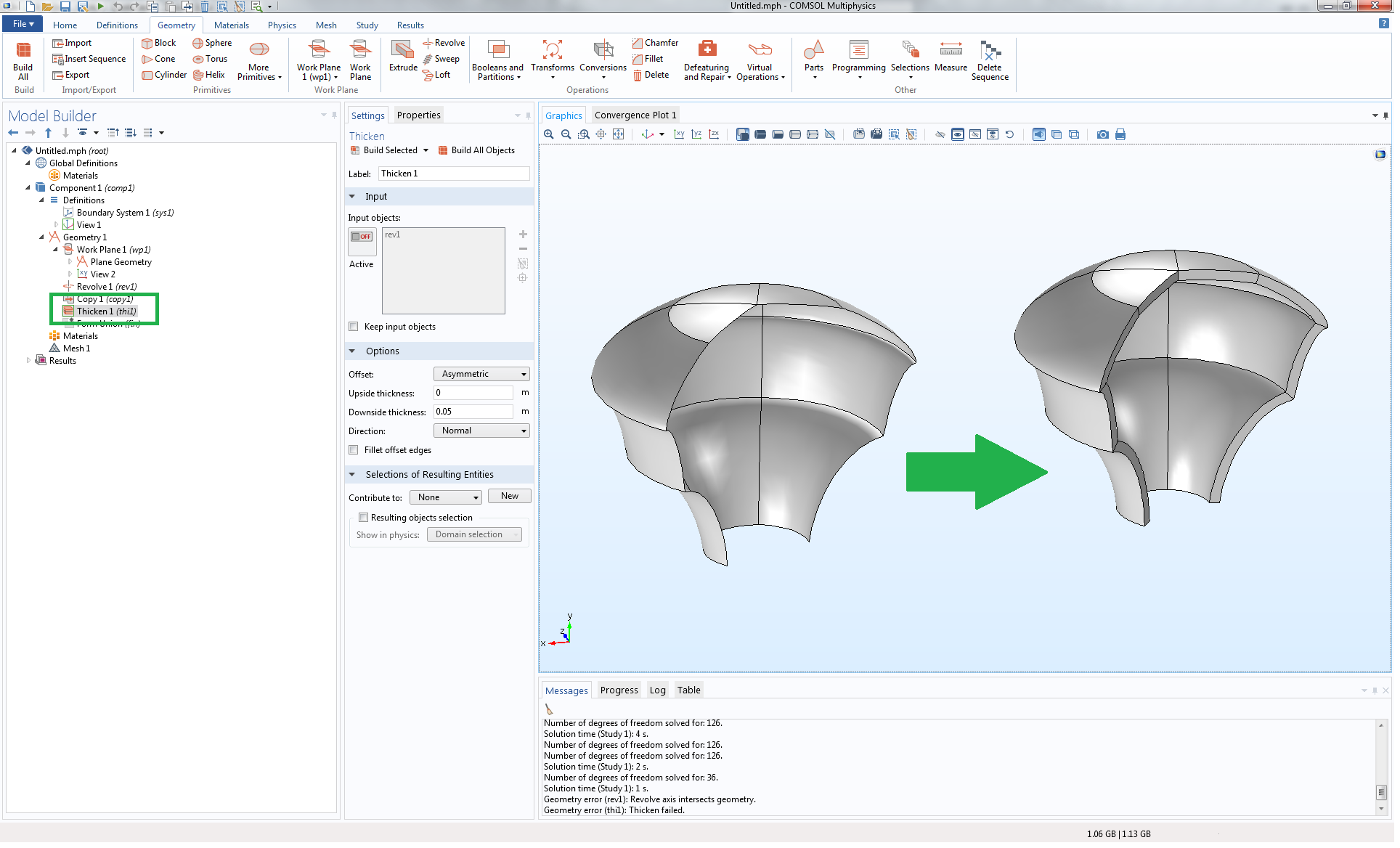

There is a "thicken" capability in the Design Module: www.comsol.com/design-module .
The attached screenshot shows how you can use it for your application to construct a second surface that's shifted a chosen distance relative to the bone's outer surface.
Hello Ulf, There is a "thicken" capability in the Design Module: https://www.comsol.com/design-module . The attached screenshot shows how you can use it for your application to construct a second surface that's shifted a chosen distance relative to the bone's outer surface. Best regards, Jeff
