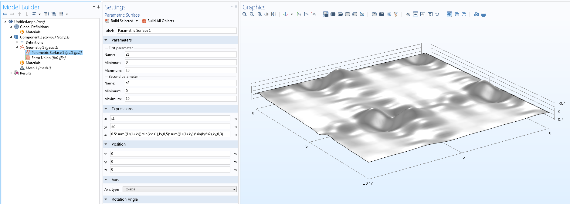

Whenever I think I need a for loop in pre- or post-processing, my mind goes straight to apps (because apps can call methods that in fact include for loops). Have you considered writing an app with a method that performs that for loop for you?
Hello Daniel, Whenever I think I need a for loop in pre- or post-processing, my mind goes straight to apps (because apps can call methods that in fact include for loops). Have you considered writing an app with a method that performs that for loop for you? Jeff

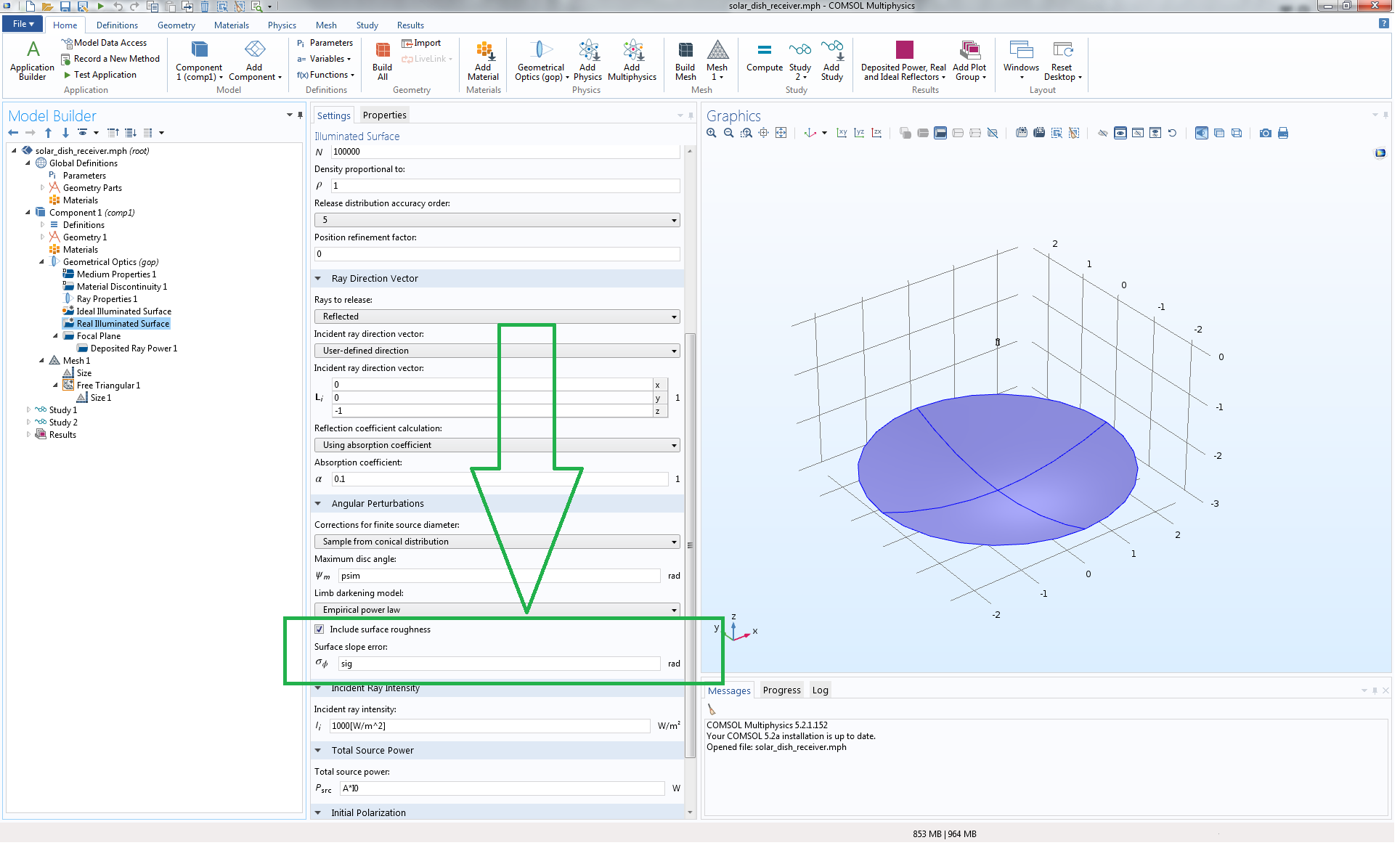

Depending on what physics are modeled, the impact of surface roughness can sometimes be accounted for without incorporating the roughness into the geometry.
You mentioned ray tracing and, indeed, COMSOL's Ray Tracing Module can account for the effect of surface roughness on rays by introducing a random perturbation to the distribution of the angle at which rays are reflected on a rough surface. See attached screenshot, from the solar dish receiver model in the Ray Optics Module's application library in version 5.2a.
This approach is more economical numerically than modifying the geometry to represent the actual irregularities of the surface.
Hello Daniel, Depending on what physics are modeled, the impact of surface roughness can sometimes be accounted for without incorporating the roughness into the geometry. You mentioned ray tracing and, indeed, COMSOL's Ray Tracing Module can account for the effect of surface roughness on rays by introducing a random perturbation to the distribution of the angle at which rays are reflected on a rough surface. See attached screenshot, from the solar dish receiver model in the Ray Optics Module's application library in version 5.2a. This approach is more economical numerically than modifying the geometry to represent the actual irregularities of the surface. Best, Jeff

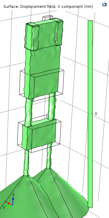

For linux, I needed to get the unicode specifiers out of that code, and additionally to get rid of some of the C++ line for (int i ...). Anyway, here's the revision, which also calculates derivatives but that's not used since I didn't know how to.
For the interface, I specify a deformed geometry with the following specifications:
x: bump(Xg,Yg,Zg) * 1[nm]
y: bump(Xg+500[nm],Yg,Zg) * 1[nm]
z: 0
This puts bumps in the x-y plane but not z. Ideally I'd have defined separately initialized bump functions for x and y, with separate Fourier coefficients, but as short-hand I offset the values for y well in excess of the autocorrelation length so despite the randomized Fourier coefficients being the same the x and y This is cheating a bit, however.
If the amplitude is increased from 1[nm] to 2[nm] the code fails. It's easy to imagine that if the gradient of a deformation component in the same direction <= -1 then there's a singularity. I suspect that's what's occurring. If I want a greater amplitude I would need to increase the autocorrelation length in conjunction with the amplitude increase to attenuate the high spatial frequency components to prevent this.
The attached image shows the resulting "lumpy" surface. The top surfaces are planar, due to a lack of z-axis displacement.
Note: I've since updated this to accept at most 125 k-points instead of 1000 in attempt to speed it. It's still really slow. The interesting aspect is the deformation is a fixed function of Xg, Yg, Zg and no of time and therefore needs to be calculated only once. I suspect it's being calculated for each point each iteration (I can't be sure of this: I should have the function write to output which should be reflected in the log). One way to do this would be to cache the results. If I had access to a node index that would be easier but I'm not sure it's evaluated only at nodes. I'm not sure...

Posted: 9 years ago 2016/06/20 19:23 GMT-4
I did modify the code to produce independent components (sharing the same k-points, but independent Fourier coefficients) for x, y, and z, so no more kludge shifting coordinates. But it's SLOOOOOW. Clearly the coordinate displacements are being evaluated each iteration, which is unfortunately.

Bjorn Sjodin COMSOL Employee
Posted: 9 years ago 2016/06/21 10:27 GMT-4
Hi Daniel,
I don't think you need to write code to do this. Take a look at the attached screenshot. There you can see how the built-in sum function can be used for this type of task. You can also nest sum functions to create double sums.
Bjorn

Posted: 9 years ago 2016/06/29 12:42 GMT-4
Bjorn:
Thanks for that! Very nice. What I like about your approach is it avoids the singularity issue with deformation fields when they decrease too rapidly along the axis associated with a given coordinate.
The remaining challenge here is randomizing the roughness. My surface involves 375 randomly chosen amplitudes, 1125 randomly chosen phases, and 1125 randomly chosen k-values. But the key is the function be evaluated only once, and the surface not change over time.
Dan
Posted: 9 years ago 2016/06/29 16:50 GMT-4
Hi Dan,
Yes, this could be done as well. You then use an expression like:
scale*sum(sum(if((m!=0)||(n!=0),((m^2+n^2)^(-b/2))*g1(m,n)*cos(2*pi*(m*s1+n*s2+u1(m,n))),0),m,-N,N),n,-N,N)
where:
* scale is a number that determines the approximate max amplitude
* b is a number, typically between 1 and 2. This is a "spectral exponent" determining the "ruggedness" and should be interpreted as 1/f^b where f is the spatial frequency in the spectral distribution of oscillations
* g1(m,n) is a random function with 2 arguments (Defined under Global Definitions>Functions>Random, with Normal distribution (mean 0, standard deviation 1)
* u1(m,n) is another random function with 2 arguments with Uniform distribution (mean 0, standard deviation 1)
* N is the number of spatial frequencies to include
Try, for example:
N=40
scale=0.01
b=1.8
s1 varying from 0.1 to 0.9 (this is really the x-coordinate)
s2 varying from 0.1 to 0.9 (this is really the y-coordinate)
Relative tolerance for the Parametric Surface 1.0E-3
Maximum number of knots for the Parametric Surface 100
The factor ((m^2+n^2)^(-b/2))*g1(m,n) represents a statistical distribution with a power spectrum that decays as 1/f^b. This method is not limited to this type of distribution but you can use any function here f(m,n) to represent a statistical distribution throughout space. You can read more in the book:
"The Science of Fractal Images" by Heinz-Otto Peitgen, Dietmar Saupe
The "if" operator is to avoid division by zero for the "DC" term of the expression.
This is an interesting topic and we may blog about it some day.
I hope this helps.
Bjorn
