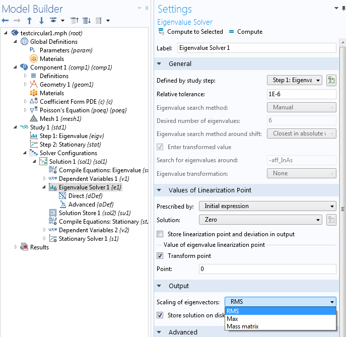

                                                    Does anyone know what the default normalization of the eigensolutions in COMSOL is. I would like the normalization conditions intop1(abs(u)^2) = 1 but I am not sure how to achieve this. I have tried to define an integral operator do investigate the normalization but I get an error. Is there any easy way to get the desired normalization? My script is attached below.
