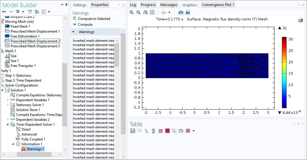

I'm trying to simulate movement of a single magnet in an air domain by using deformable mesh. But the magnet's mesh is not being translated linearly. It returns a warning, saying "Inverted Mesh element" or sometimes returns error, "Relative error greater than tolerance". I defined the mesh displacements similar to the ones given in the moving magnet example. Here I attach the image of the result after magnet being translated. The magnet is not being maintained as a single rectangle its sides are warping.

Posted: 9 years ago 2016/07/05 10:21 GMT-4
Simply increase the fineness of the mesh. If you put a chamfer or a rounded 0.5 mm for example, and your mesh is 1mm, then you have an error message.

Posted: 9 years ago 2016/07/06 9:14 GMT-4
Thank you for the post. But I'm still facing the same problem, can you please elaborate on the meshing method. I tried meshing as said by using form assembly and identity pairs, also tried a very fine mesh. I am trying to simulate a square magnets motion in a rectangular air domain. The edges of the mesh outside the magnet seem not to move. But the ones attached to the magnet are pulled with it, making it deform very much and is causing an inverted mesh error.
