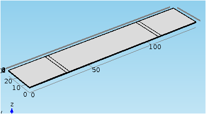

I am totally new for working on COMSOL 5.0. This is my learning stage. First I have simulated the COMSOL tutorial, based on piezoelectric energy harvester and on the basis of that I am implementing model for doubly clamped piezoelectric energy harvester with segregated electrodes . I have to observe its voltage and power response in frequency domain. According to the attached paper, i have designed a cantilever beam with length=140mm, width=25mm and height 0.8mm. In this design 0.3mm piezoelectric layer has been sandwiched between two segregated electrodes. I have used blocks to implement this design. Please find the image in attached file. I am using PZT 5A for piezoelectric , Silicon for substrate and aluminium for electrodes. I have following doubts related to its geometry.
(1 )The way by which i have implemented the device is correct or i did something wrong, Kindly suggest.
(2) Have electrodes should be defined through blocks or there is some another way to defined them.
Apart that, I am stucked at meshing point. Lots of errors have been raised due to the thin height of the beam. I don't understand that how to use electrical circuit here to obtain voltage across a resistor in frequency domain.
