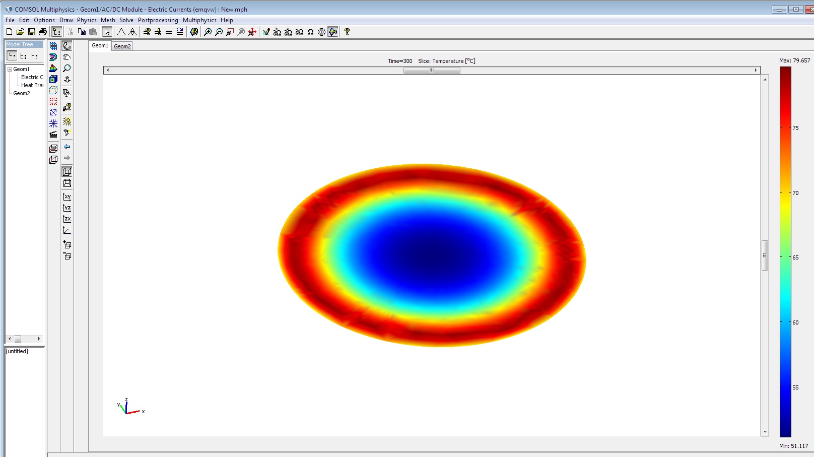

How can I get min,max, and standard deviation of tempertures for the attached slice using FEMLAB?

I assume its rather close to the 3.5a: export the data to matlab (but you are probably already there with FEMLAB) get the result on the desired boundary/ surface/line... via an interpolation operator and run a max or min matlab function call on the array
Hi I assume its rather close to the 3.5a: export the data to matlab (but you are probably already there with FEMLAB) get the result on the desired boundary/ surface/line... via an interpolation operator and run a max or min matlab function call on the array -- Good luck Ivar

Thanks a lot for your help. I was able to export the data.
Ivar, Thanks a lot for your help. I was able to export the data.
