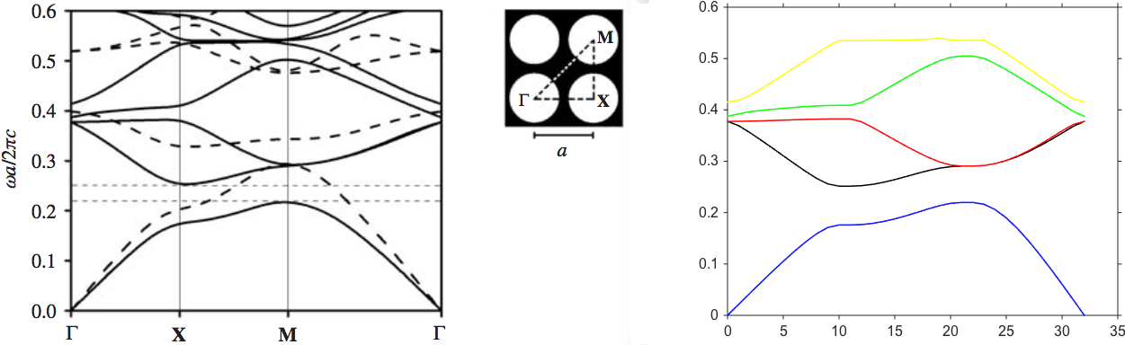

Bandgap of a 2D photonic crystal by COMSOL MATLAB scripting
I would like to share my MATLAB script that reproduces Figure 6.8 of the textbook

Attachment 1 is the script, and attachment 2 shows the textbook figure (left) and the figure generated by this script (right) side by side.
Alternatively, see demo and code here: github.com/xiumingzhang/photonic-bandgap-comsol-matlab
