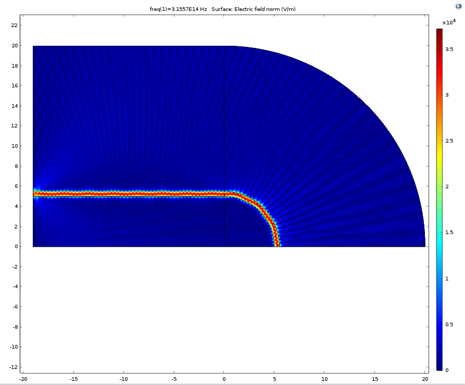

I have made a simulation in which I have waveguide which bends. I have found the Electric field. I want to compute the bending loss by comparing the total intensity/power at input and output. Please see the attached file.

Have you tried Derived Values -> Global Evaluation -> -20*log10(ewfd.S21)? Didn't look at your file.

Thank you. That Helps.
