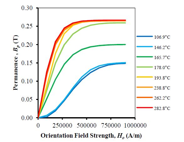

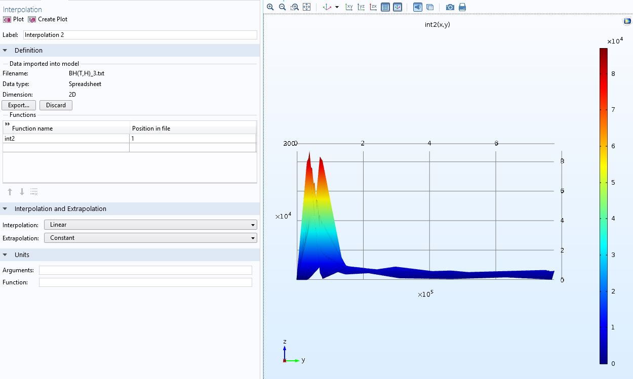

I tried to create a 2D interpolation for my B(T,H) function but unfortunately it hasn't worked like I expected.
I expected a graph similar to the picture: B(T,H).jpg but COMSOL creates this: B(T,H)_COMSOL.jpg. The data of the .txt (all in one file) file I used you can find below.
I do not understand what COMSOL is creating there especially because of the axis scale and the course of the graph. I know that the B(T,H) function can be displayed on an area using two axis for the arguments and colors for the function value, but in this case I don't see where the graph fits the data I have given COMSOL.
In the end COMSOL should be able to calculate the flux density B[T] based on the given parameters T [°C] and H[A/m] whereas the temperatur T will be imported from another simulation as I mentioned before.
Can you pls give me a hint what I'm doing wrong? Do I have to format my data in a different manner or do I have to split the data into several .txt files?
I don't know how to move on right now and I hope you can help me again!
Thank you very much!
Maximilian

The decimal comma may be the culprit. Comsol needs a decimal point. For what you want to do, you need the 2D interpolation B(T,H). If you want a multitude of curves you have to import 1D interpolations seperately for each temperature. But I guess this won't get you where you want to get.
