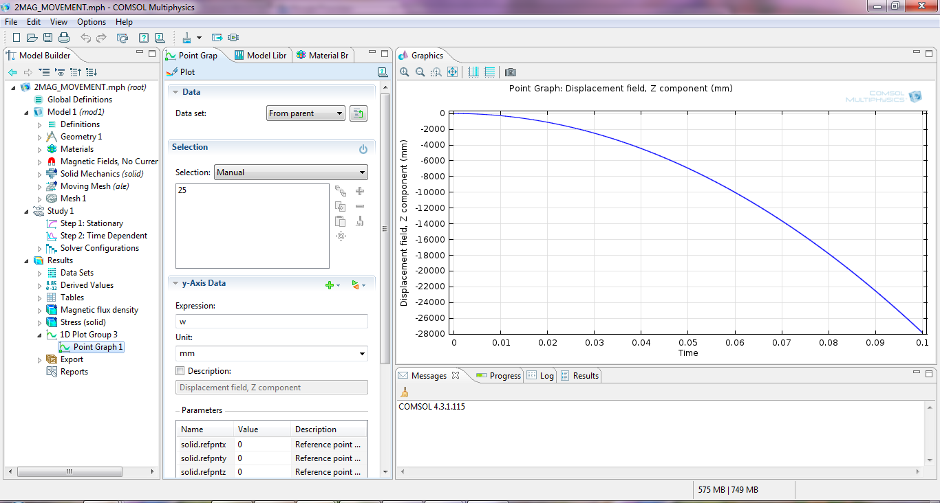

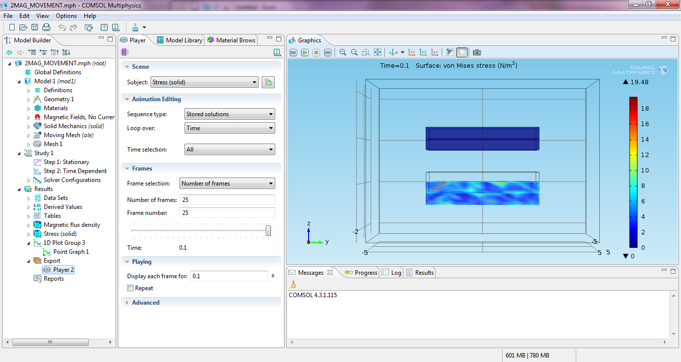

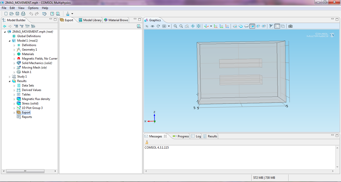

Posted: 1 decade ago 2014/12/26 3:20 GMT-5
HI
I am trying to simulate repulsive force between two permanent magnets. One of the magnets is fixed and the other one moves freely. I have simulated it but two things in results make me confused:
1. Repulsive force in all times is the same. But we know that, as the second magnet goes far away first magnet, forces must become lesser.
2. I plotted displacement of one point on moving magnet. Graph shows displacement of 28000mm in 0.1 second (:-o). But animation shows about 1mm displacement.
What is the problem?
Can anyone help me?
