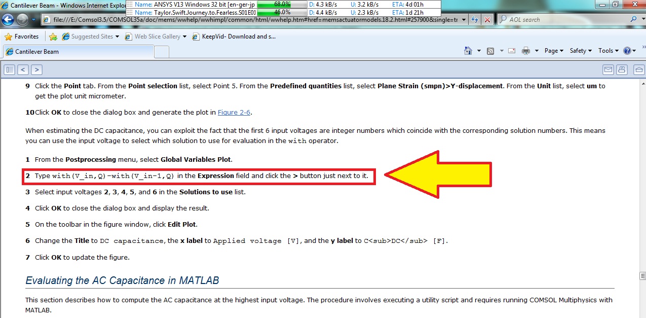

Yes I've checked it and I was trying to repeat all the instructions in the documentation [documentation for simulation of a mems cantilever] but in postprocessing part where the capacitance is calculated I cannot get the plot described in the documentation instead comsol says that it cannot understand the "with operator"
the documentation is attached.
Please help me with this.
Also i cannot find anything about that "with" operator too, please give me a reference for finding information about it or ...

                                Ivar KJELBERG
                                                Posted:
                                1 decade ago
                                2010/12/11 11:38 GMT-5
normally the with() ad at() operators are used to catch a moment in a transient analysis (at() the desired interpolated time moment t) and the with() at the frequency (frequency sweep) or particular mode (eigenfrequency analysis)
These operators are described in the doc, do an indexed search on the doc to find them ;)
There are also examples of apacitive extraction depending on the model you build.

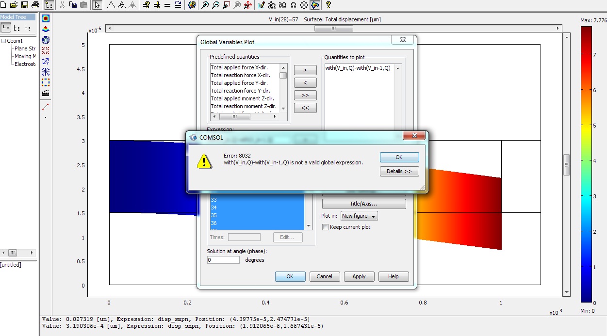

                                                    Hi and thank you
  Yes I see..
but why when I want to calculate the value it gives me :
   Error 8032
   with(V_in,Q)-with(V_in-1,Q) is not a valid global expression
i also attach the picture.
Thank you very much for your help
