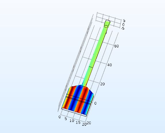

So far I generated two modells with different geometries. In my first modell (20x20x1_1.0s) I'm able to plot the solutions properly (temperatur plot/Plot flux density (BT entformt).

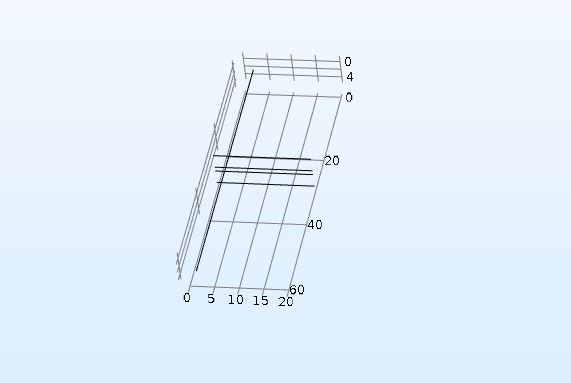

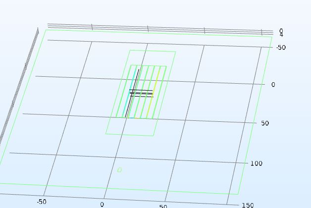

This modell I used a basis to generate my second modell with a slightly different geometry (20x60x1_1.5s). I used exactly the same settings but for some reasons I'm unable to plot/calculate the solutions (temperatur plot_new modell/Plot flux density (BT entformt)_new modell) like they showed up in the first modell. It seems that only the edges are displayed but not the whole part.

Maximilan,
You can not see all geometrical entities in you plots because several domains are hidden - take a look at Component/Definitions/View node.
Sergei
Maximilan, You can not see all geometrical entities in you plots because several domains are hidden - take a look at Component/Definitions/View node. Regards, Sergei

Sergei!! You are my hero right now!
Thank you so much....I have no idea how I could overlook this
Best wishes,
Maximilian
Sergei!! You are my hero right now! Thank you so much....I have no idea how I could overlook this Best wishes, Maximilian
