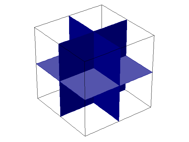

                                                    Thank you very much Robert ! I appreciate what you did here. I did this thing in my own way previously but somehow that was taking more than 5 hours to compute but then I have done in the way you suggested, took at max 3 mins to compute. I really appreciate it !
However, if I want to put an antenna in the box then the plane wave doesn't go through the antenna. I couldn't even get the electric field along the direction that was estimated previously. I have attached the Ex Vs t graph. I don't know for which reason the plane wave is not propagating through the whole way to the end of the Air box. Is it because the plane wave doesn't get enough time to come to steady state condition before the antenna interrupted the propagation?
I was wondering what is the problem and how it can be solved ? Please let me know. Thanks in advance !
-Rishad
-Rishad

                                                    I can't tell from the figure.  I suggest that you post your .mph file.  (Clear the solution and mesh first, to make the file small enough in size.)

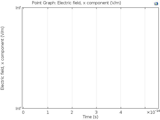

                                                    Hello Robert, thanks for your response. I was just waiting for it. I am answering your question one after one so I hope we don't miss points here.
1. Mesh: I know the mesh is much coarse. Technically, it's a default mesh. I am limited to 4GB memory in my working pc so didn'tintend to do finer mesh to early when I still have to find out how to solve the problem. But thanks a lot for your concern about that.
2. Lumped Port: I didn't think of it previously but what kind of feed can I get from this lumped port. Can you suggest how to use it here in this case ?
3. Clear Solution: I misunderstood you in this case. I thought I would rather not specify anything in the mesh and solution so you can find out the problem here.
4. Point Plot: I have attached another mph file which includes mesh (default) and Results sections as well.
I think, I am having the problem because of the material properties in this model. The permittivity of gold here is a complex number and frequency dependent as well. How can I define frequency-dependent material's complex permittivity  in time domain simulation? This is suppose to be the main problem here. Any idea from you would be great !
Thanks Robert ! Kindly,  let me know.

                                                    1.  You do need a finer mesh.  You have two planes of symmetry.  Consider creating a 1/4th of the problem representation, to help you make better use of your very limited memory.   (You will have one PEC plane and one PMC plane of symmetry.)  You may also need to go to an iterative solver instead, if the problem is still too computationally large for your computer.  Consider getting more memory or a newer computer.
2.  Consider plotting log10(temw.normE) for your point plot, so you can see the initial tiny values showing up.
3.  For a port, consider putting a line segment connecting your two triangles in the work plane, and extrude that along with the triangles.  Then in 3D assign the resulting rectangle there as a lumped port, user-defined, and fill in the details.  Use the Comsol help system to guide you on what those details mean.  That's how I learned it, so you should be able to also.
4.  In your material properties for gold, you'll need to specify a non-zero value of the conductivity (what you called sig_g) if you want to represent, in the time-domain, what would otherwise be a complex quantity in the frequency domain.  Do not try to assign a complex number to a material property in a time domain problem, since that would be nonsensical.  You can find the relationship between complex dielectric constants and a real dielectric constant with a finite conductivity in any good EM textbook.  (And looking that up will help you better understand this topic, so you really should do that.)  Choose sig_g accordingly, for your frequency of interest, based on literature you have (or can find) about the known properties of gold at the frequency of interest.
Good luck.

                                                    Thanks a lot Robert ! It worked apparently. Still need some more works to do on it.
