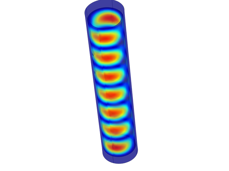

Posted: 1 decade ago 2010/12/24 12:46 JST
Hey again, so I'm still having some issue
I was able to get modes by adding a scattering boundary conditions and an incident plane wave, like I said earlier and I got modes like shown in the image
But I can no longer get the same modes by running the same file, but I cant tell what/if anything's changed
Hey again, so I'm still having some issue I was able to get modes by adding a scattering boundary conditions and an incident plane wave, like I said earlier and I got modes like shown in the image But I can no longer get the same modes by running the same file, but I cant tell what/if anything's changed
