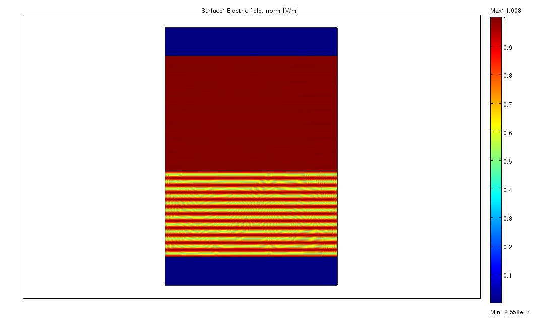

I started with 2D scattered TE wave module. The geometry is attatched as a file. The top layer is a PML, 2nd is a layer with n=1, 3rd is a layer with n=2 and the bottom layer is a PML.
Incident wave is " exp(j*k0_rfweh*y) "
The result attated says 'electric field, norm' is fluctuatiing in the region of n=2, but it's nonsense I think..
There should be only a transmitted wave in the layer with n=2 so that the norm of E field shoudm't be fluctuate.
What's wrong with me?

I would say nothing is wrong !
if you have an electric fied (plane wave) propagating from the bottom upwards, hitting the index interface you have reflection and part of the field is coming back, hence making a standing wave, that you see nicely, but your remaining straight propagating wave is not reflected by the PML so the norm of the filed is constant
Hi I would say nothing is wrong ! if you have an electric fied (plane wave) propagating from the bottom upwards, hitting the index interface you have reflection and part of the field is coming back, hence making a standing wave, that you see nicely, but your remaining straight propagating wave is not reflected by the PML so the norm of the filed is constant -- Good luck Ivar

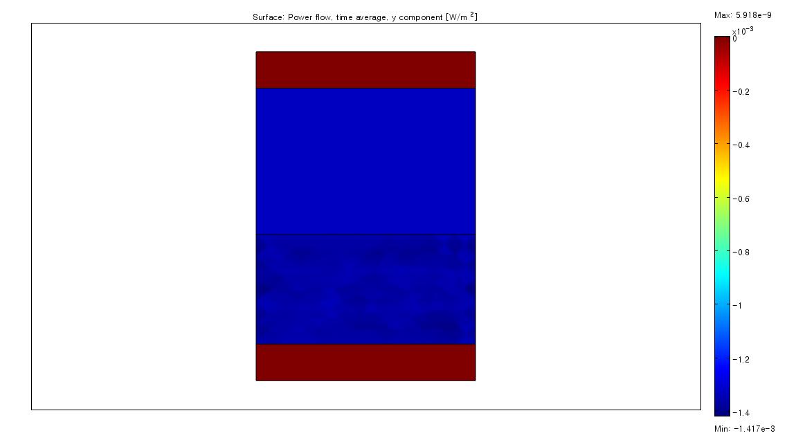

BUT the wave is propagating from top to bottom. The incident electric field is set as exp(j*k0_rfweh*y), and this is propagating to -y direction. Also you can find from attached file that the power flow is -y direction.
What on earth the problem?!
Thank you for your answering! BUT the wave is propagating from top to bottom. The incident electric field is set as exp(j*k0_rfweh*y), and this is propagating to -y direction. Also you can find from attached file that the power flow is -y direction. What on earth the problem?!

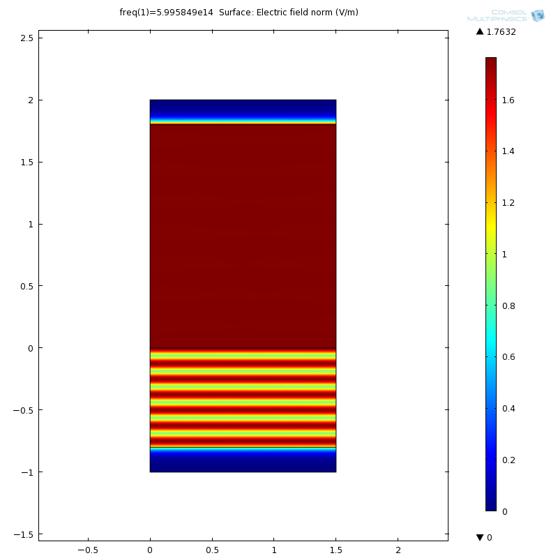

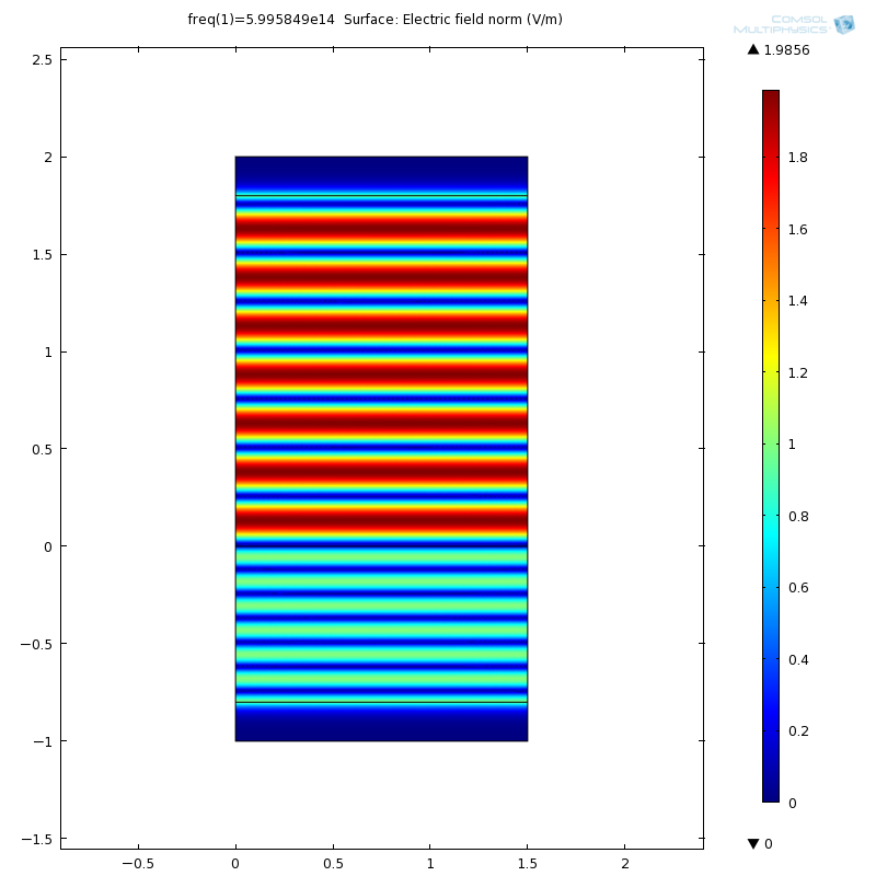

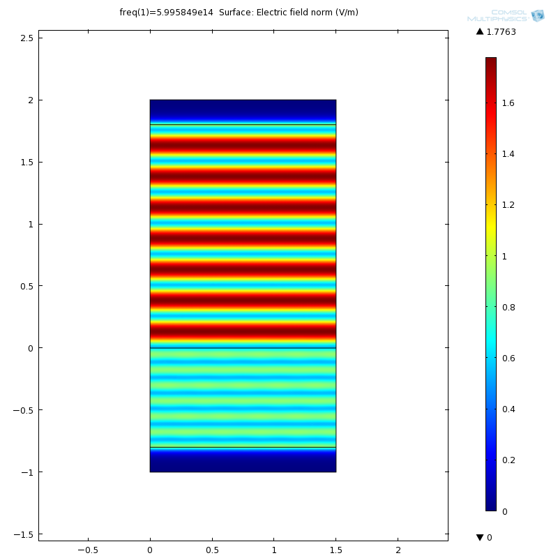

I modelled something similar in v4.1 and it looks like a "upwards" results see attached:
Hi I modelled something similar in v4.1 and it looks like a "upwards" results see attached: -- Good luck Ivar
