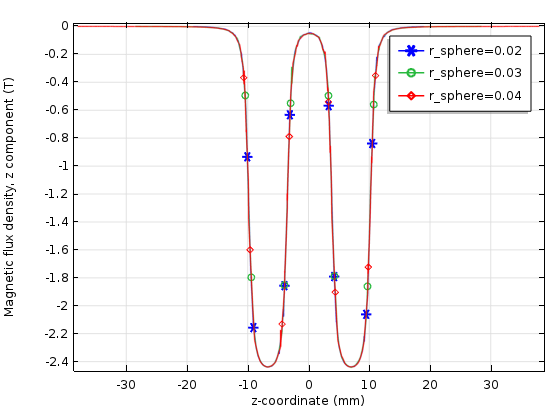

I'm trying to model the magnetic field generated by two permanent bar magnets (Neodymium magnets) but when I plot my data increasing the size of my air domain significantly changes the plots. I have tried using an infinite element domain to rectify this, but it didn't work for me. Any help would be appreciated, and my model is attached.

Attached is your slightly modified model showing that magnetic field distribution remains the same for different air sphere radius.
Sergei
Christopher, Attached is your slightly modified model showing that magnetic field distribution remains the same for different air sphere radius. Regards, Sergei
