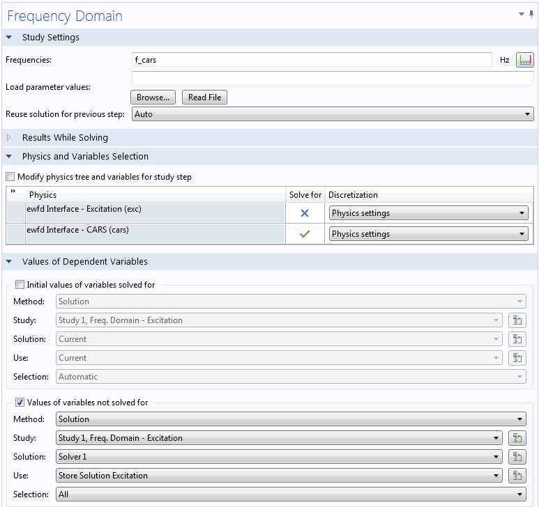

Eventually, I found out I have to configure the second study step to inherit from the first step all Dependent variables not solved for, see attached snippet.
This seems to have solved the problem. However, does this means the "with" operator can be used for calculations as well, and not only in postprocessing?
