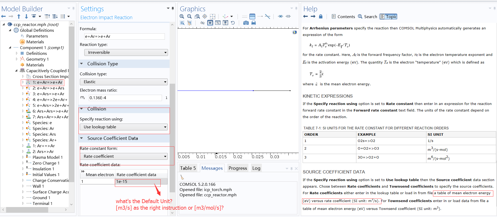

Posted: 9 years ago 2016/10/07 16:50 JST
Are you a user or worker for COMSOL?
Actually for the electron impact reaction, a list of electron energy vs. rate coefficient can be loaded in COMSOL. Please see the attached picture about a snapshot of the "Settings" window.
Are you a user or worker for COMSOL? Actually for the electron impact reaction, a list of electron energy vs. rate coefficient can be loaded in COMSOL. Please see the attached picture about a snapshot of the "Settings" window.
