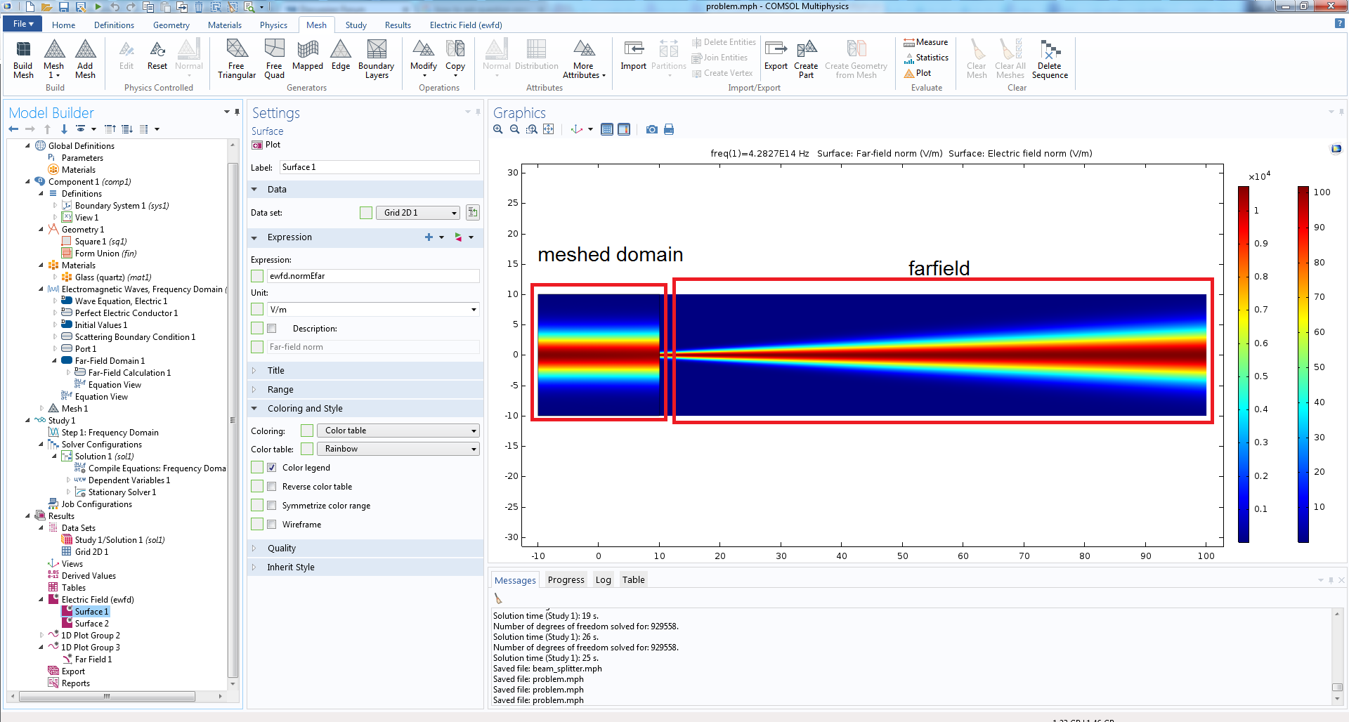

I feel something is wrong in far-field calculation in RF module. Please have a look at the attached mph file. There is a simple square where an EM wave comes in from one side and exits from the other. when I use grid 2D to see the far-field out of the meshed domain, It's always wrong, as you see in the attached picture while it should basically nicely follow the field inside the domain. The field inside is not continuous at the boundary. Funny is that even if you move the domain for example far away to the right side and solve it, the far-field stays the same at the previous place.
I tried PML at the boundary but no change.
Can anyone help me?
