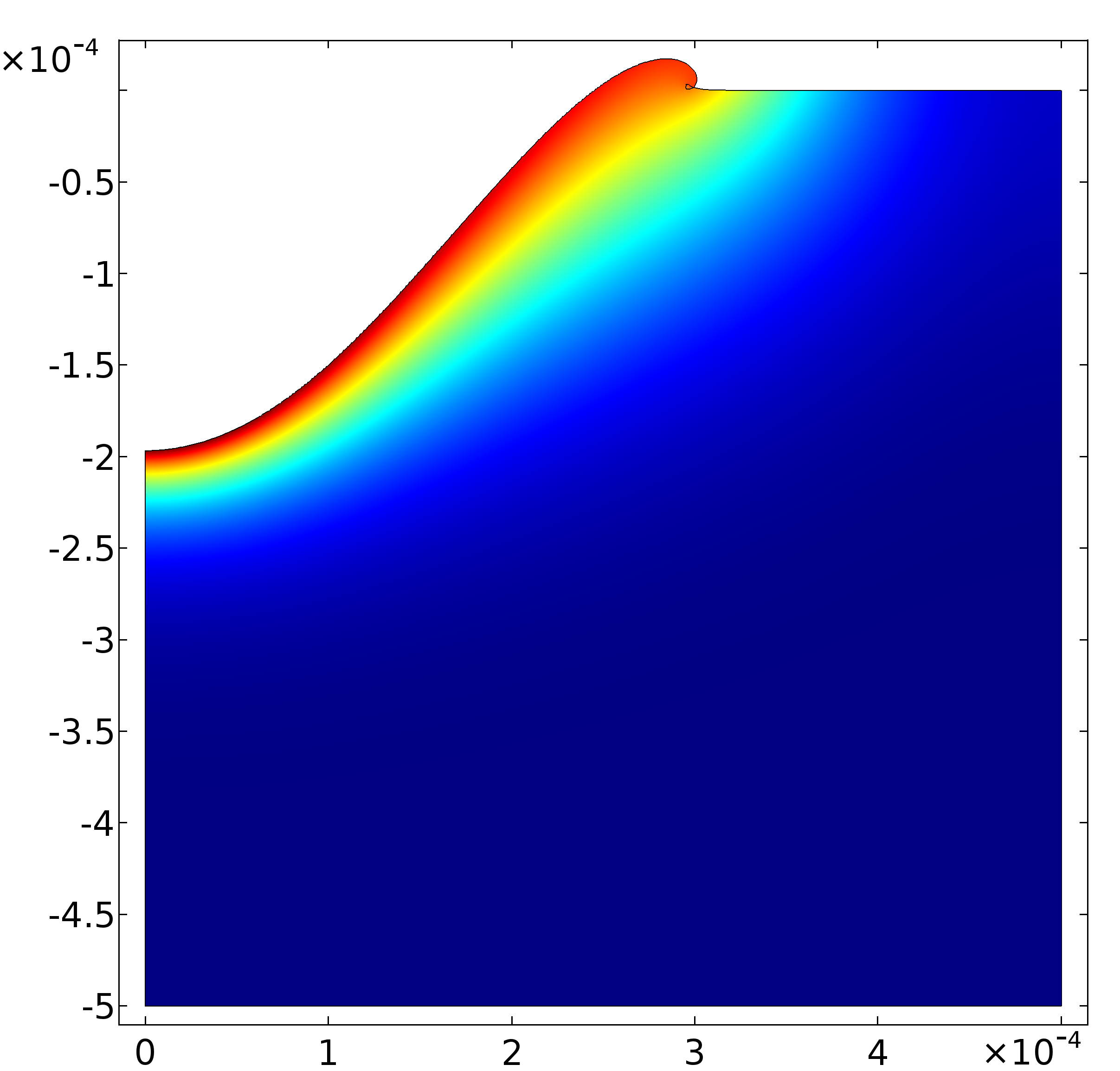

I'm simulating a model in which an external pressure acting on a limited area pushes on a viscous liquid that is evaporating. The viscous liquid surface is going down with a prescribed velocity, and with the pressure acting on the center of the hole the liquid forms a rim on the surface, as you can see in the figure.

During the simulation, while formation of the rim, the solver remeshes when condition on quality is encountered. But happens that the upper edge folds onto himself as you can see in picture, and the solver stops with "intersecting element" error.
I'm asking you: is there a way to impose to solver to ignore the fold up and to impose to remesh correctly the domain? How can I impose to merge the upper edge with himself when it falls onto himself?
