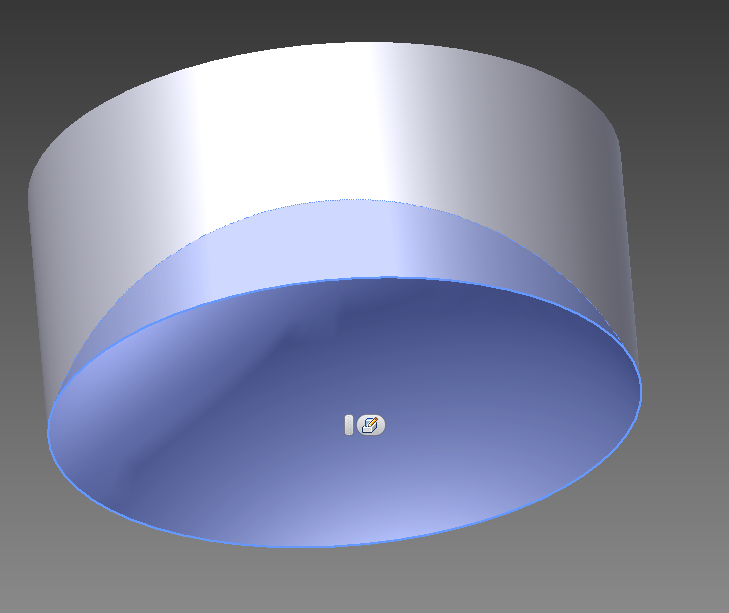

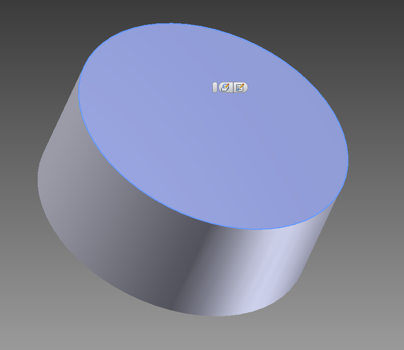

- compressive load (about 700 N) on upper, flat surface (shown in picture 1)
- fixed constraint on lower, concave surface (shown in picture 2)

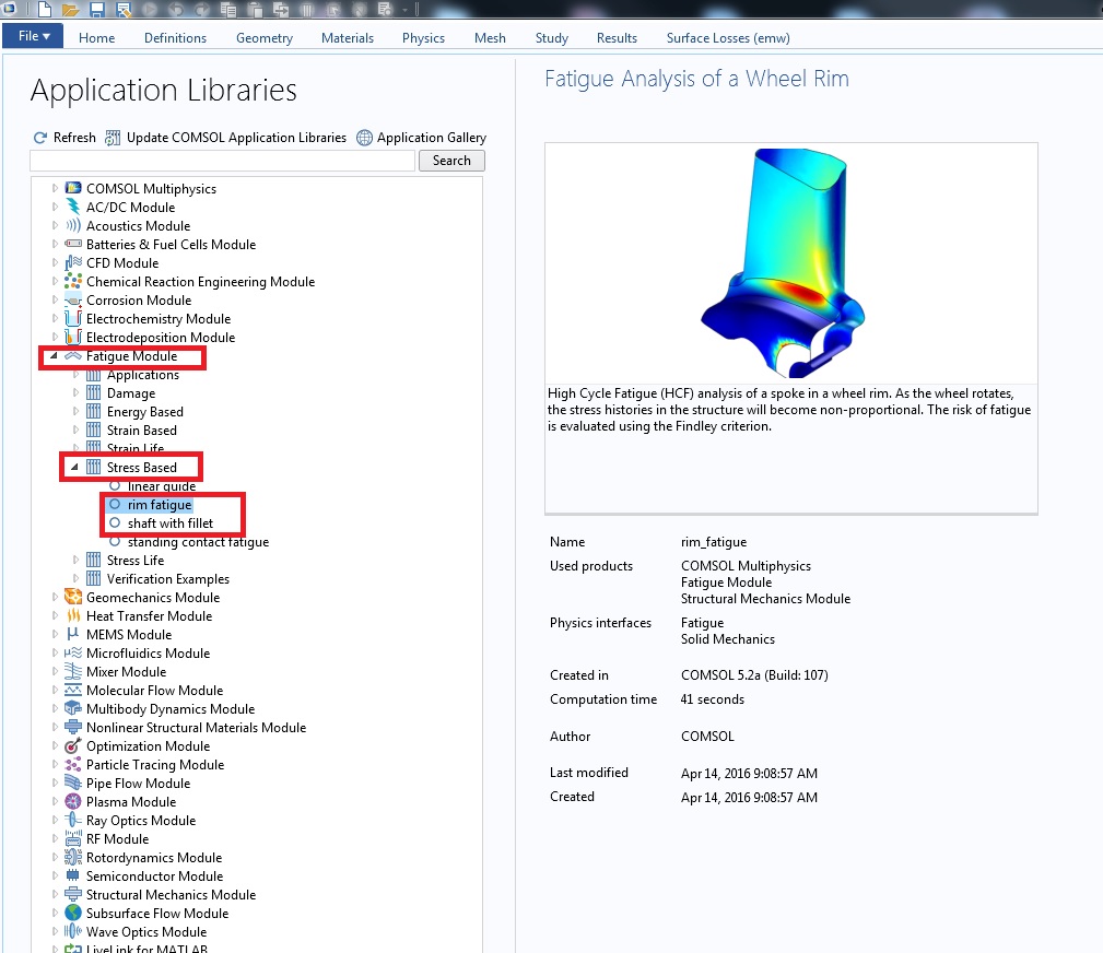

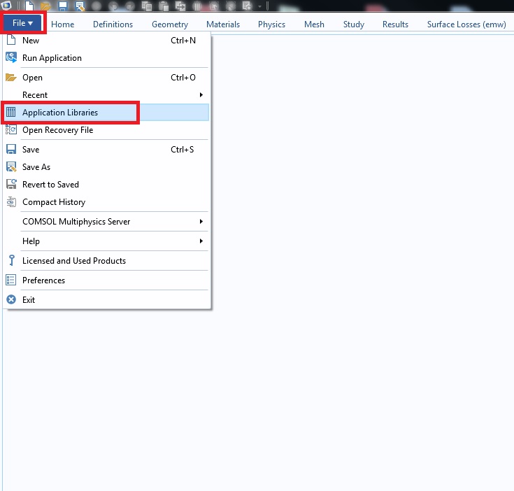

please have a look at our examples in the application library of COMSOL. I would suggest to start with the models in the folder "Fatigue Module -> Stress Based" particularly the files "rim fatigue" and "shaft with fillet". For your convenience, I also attached screenshots to this message to point out the location of these files. This should give you a good starting point to implement your own geometry.
