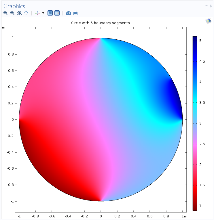

Just so that there are no doubts about the abilty to create extra boundary regions. A circle object in COMSOL Multiphysics is already divided into four boundary segments starting and ending at 0, 90, 180, and 270 degrees (for an unrotated circle). You can add a point object at the circle perimeter to create another boundary split at an angle of 30 degrees, for example, using the point coordinates
x: cos(30[deg])
y: sin(30[deg])
Then solving a simple equation on the circle with the boundary number as the boundary condition, you get a solution as in the attached image, with the value 1 on boundary 1, 2 on boundary 2, and so on, for the 5 boundary segments that the circle perimeter consists of.
Magnus Ringh, COMSOL
Hi, Just so that there are no doubts about the abilty to create extra boundary regions. A circle object in COMSOL Multiphysics is already divided into four boundary segments starting and ending at 0, 90, 180, and 270 degrees (for an unrotated circle). You can add a point object at the circle perimeter to create another boundary split at an angle of 30 degrees, for example, using the point coordinates x: cos(30[deg]) y: sin(30[deg]) Then solving a simple equation on the circle with the boundary number as the boundary condition, you get a solution as in the attached image, with the value 1 on boundary 1, 2 on boundary 2, and so on, for the 5 boundary segments that the circle perimeter consists of. Best regards, Magnus Ringh, COMSOL
