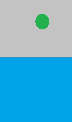

is it possible to model surface between air and water ? I'm new to Comsol. would you please describe more?
I have attached the simple model. I am eager to see surface change during the process.
Gray : Air
Green : Ball
Blue : Water
Thanks

certainly possible, but that's the trickyest example, i.e. how to define the contact and change in topology ? probably one need to try with a level set methode, but it means formula tweaking, and fun, but too much to do for now and here, for me :)
Sorry cannot do better, but try already a falling ball in a tube of water, once you have that running, you should also have some good clues how to continue
