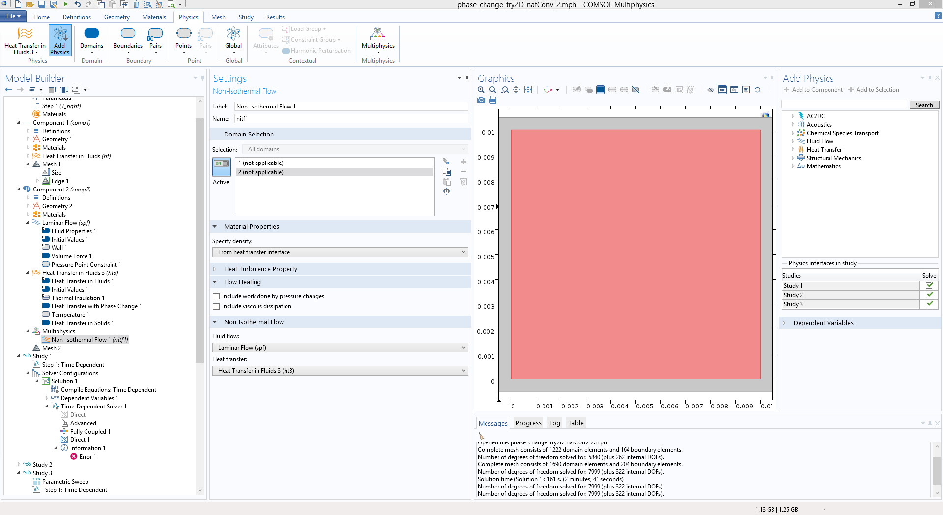

I am adding natural convection to a simulation of ice melting in 2d. I have added laminar flow as well as heat transfer in fluids with a 'heat transfer with phase change' and I have set the domains there for the solid and fluid.
However when I get to the multiphysics component, I am unable to select the fluid domain. All domains appear as 'not applicable'. Please see attached screenshot
Could someone please point out how I can resolve this issue?
Many thanks
Jesse

I have the following selected
where 1 is the outside solid and 2 is the inside fluid
Heat transfer in Fluids 3 (ht3) : [1 & 2]
Heat transfer in Fluids 1 : [1 & 2 (both overridden)]
Heat transfer with Phase Change 1 : [2]
Heat Transfer in Solids 1 : [1]
in the Laminar Flow domain only domain 2 is selected
@Sohan, thank you for the reply. I have the following selected where 1 is the outside solid and 2 is the inside fluid Heat transfer in Fluids 3 (ht3) : [1 & 2] Heat transfer in Fluids 1 : [1 & 2 (both overridden)] Heat transfer with Phase Change 1 : [2] Heat Transfer in Solids 1 : [1] in the Laminar Flow domain only domain 2 is selected

Posted: 9 years ago 2016/11/30 4:06 GMT-5
so it seems the only way I can select the fluid domain in the 'non isothermal flow' component is to disable 'Heat transfer with Phase change' in 'heat transfer in fluids'
Are these two modules not able to work together? If so, how do I manually couple the heat and fluid flow?
many thanks
Jesse
so it seems the only way I can select the fluid domain in the 'non isothermal flow' component is to disable 'Heat transfer with Phase change' in 'heat transfer in fluids' Are these two modules not able to work together? If so, how do I manually couple the heat and fluid flow? many thanks Jesse
