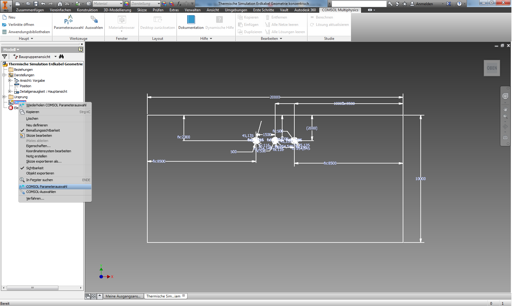

The LiveLink button in COMSOL is not active so could it be that my license does not contain the LiveLink™ module (Picture 2)? I put some pictures in this thread.

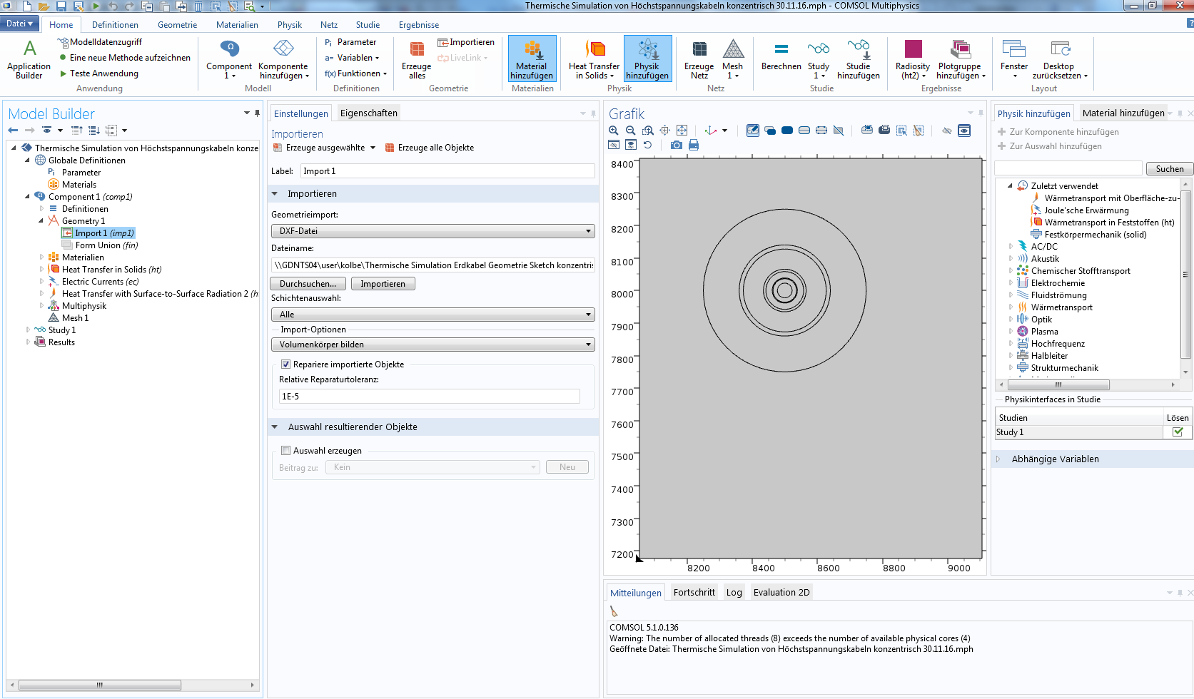

Maybe I do something wrong. To get more detailed what I do now is the following:
1. 2D-Sketch in Inventor with definings (parameters)
2. Right-click Sketch and choosing COMSOL Parameter Selection (Picture 1)
3. Enable "Add to COMSOL Model" for all Parameters
4. Export sketch as a .dxf file
5. Import .dxf file in COMSOL at geometry node
My parameters are not there. So I wanted to try out LiveLink™ but I came to the problems above.

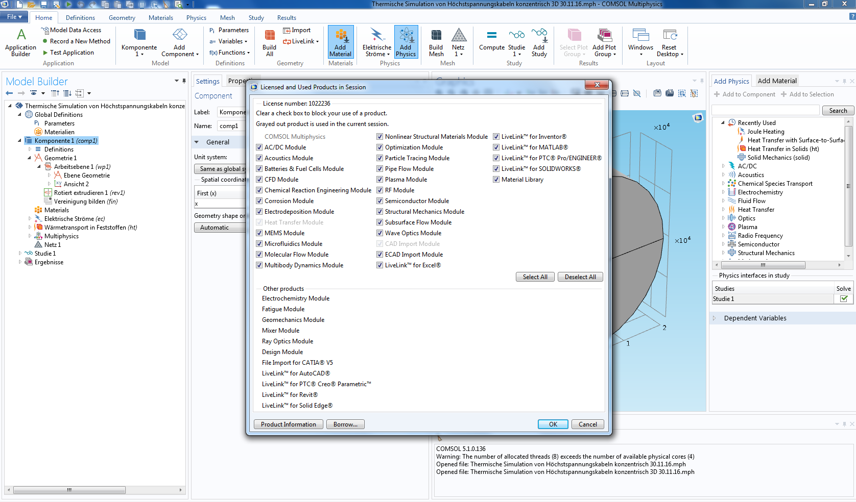

You can check what products you have access to on your license by going to (in the English language GUI) File>Licensed and Used Products.

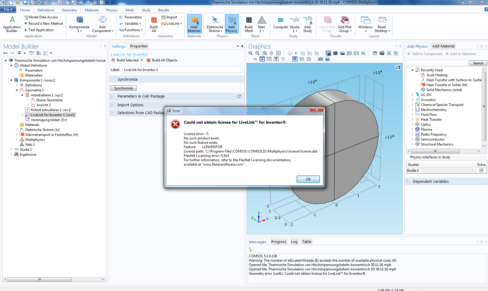

I converted the geometry in Inventor to 3D then imported it into COMSOL. I added a LiveLink node and a Working Plane node to the geometry node to get to my 2D cross section.
Relating to the COMSOL License settings I have the required license for LiveLink (Picture 1).
Somehow if I want to synchronize between COMSOL and Inventor the error on picture 2 is displayed.

Jeff Hiller COMSOL Employee
Posted: 9 years ago 2016/12/06 9:11 GMT-5
Hi Jan,
I am afraid I don't know the answer to the first part of your message, regarding licensing. I'd suggest contacting the support team.
