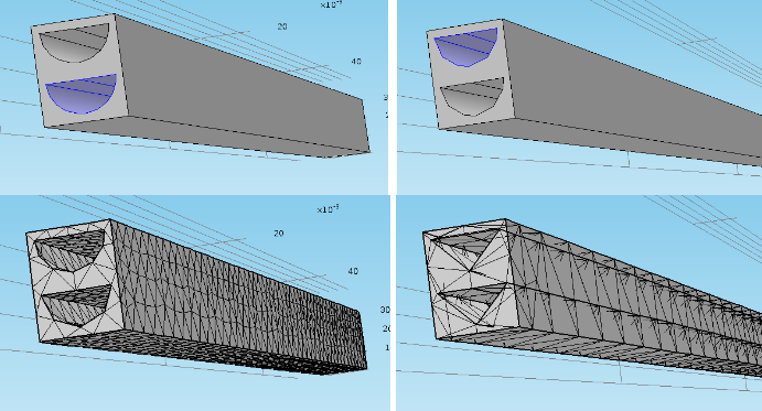

Hi All,
I am trying to model a single unit of a counter-flow heat exchanger. The channels are half circles with diameter of 1 cm. If the length is short (<10 cm) comsol does fine. If the length increases then things start looking weird and comsol has errors in building the mesh. Any ideas on what might be going on and how I might address it?
The attached pic shows a 5 cm long channel on the left and a 20 cm long channel on the right.
Thank you,
Bryan
1 Reply Last Post 2016/12/08 8:13 GMT-5
Jeff Hiller COMSOL Employee
Posted: 9 years ago 2016/12/08 8:13 GMT-5
Hello Bryan,
High aspect ratio geometries like yours are prime candidates for swept meshing.
See Reference Manual for COMSOL Multiphysics, version 5.2a, Chapter 8.
Hello Bryan, High aspect ratio geometries like yours are prime candidates for swept meshing. See Reference Manual for COMSOL Multiphysics, version 5.2a, Chapter 8. Best, Jeff
