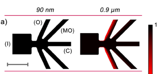

I am modelling my microfluidic device and so far i have configured all the relevant physics needed to study the behavior. I have attained the electric field, voltage distribution plots etc.
However, next, i wish to flow two differently sized particles through the channel and see their concentration distribution at different locations in the channel. Please refer to the image attached here, that is what i wish to achieve.
I am certain, Particle tracing module must come in handy and i defined two particles as per my experimental specifications. However, i am clueless how to proceed towards getting that sort of a gradient plot.
As of now, i tried running the time-dependent computation for particle trajectories, but it just sits at 4% execution. My step size for this is fair at range(0,1,25) for gathering results. Maybe this leads to a plot of that sort?
