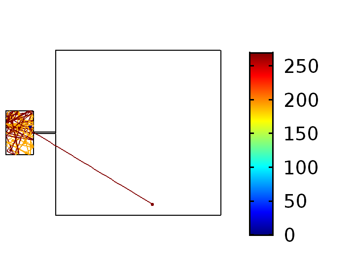

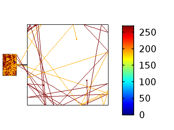

Hi Dan,
I had a look at the model you suggested and it looks like it pointed me in the right direction. To start off with, I have set up a basic "particle tracing for fluid flow" physics node, but it's the first time I've tried it and I am getting mixed results.
The first attached image shows an attempt at replicating the "beaming" effect which I have been able to produce using a very similar geometry in MOLFLOW (molflow.web.cern.ch/). As you can see, most of the collisions are handled fine, but there is one particle which (after several reflections on other faces) passes straight through one of the walls. The second image shows a later timestep, after which several other particles show the same behaviour.
For this test, all walls are set to "Diffuse scattering" with wall accuracy of order 2. The colour scale for the images corresponds to the particle velocity, which is set to Maxwellian.
I'm not sure what the cause of this behaviour is, but it is clearly unphysical and since I'm interested in transmission through the narrow channel, it's quite annoying! I've tried lots of different mesh sizes and time steps but the problem seems to persist. Do I simply need to find the right parameters, or is something else in play here?
The model file (mesh + results cleared for file size reasons- settings as-is take 10s to run on my machine) is attached.
