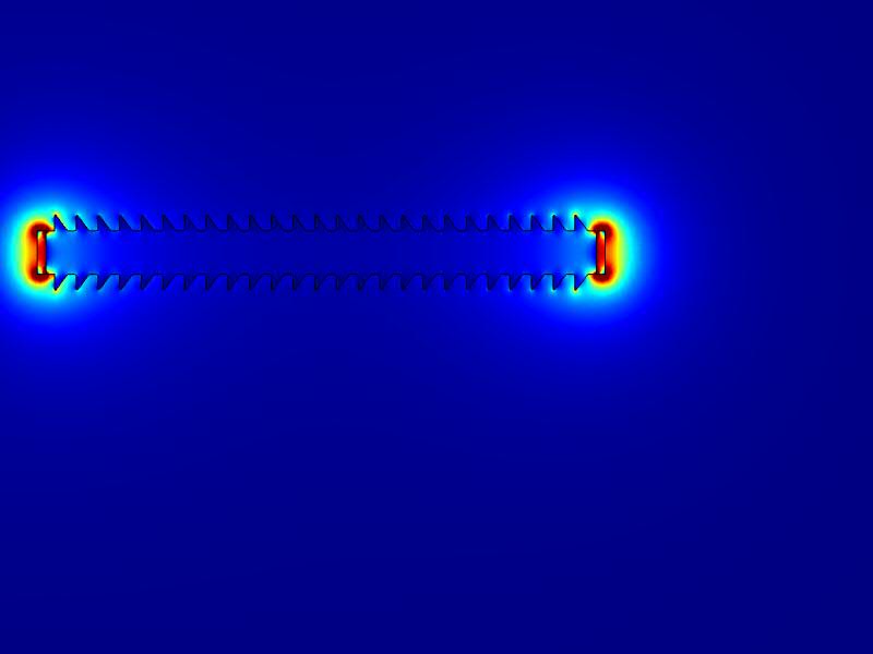

I'm new to COMSOL.. currently I'm working on a simulation to study the electric field along an insulator. I've been using the method told by Roman, but unfortunately the electric field simulated was not as expected...the electric field on the energized end should be higher than that of the grounded end, but from the simulation result the electric field level is same for both end... anyone can help me?
Hi, I'm new to COMSOL.. currently I'm working on a simulation to study the electric field along an insulator. I've been using the method told by Roman, but unfortunately the electric field simulated was not as expected...the electric field on the energized end should be higher than that of the grounded end, but from the simulation result the electric field level is same for both end... anyone can help me?
Posted: 1 decade ago 2013/06/12 0:21 JST
there is no reason why the fields should be different on both ends. Don't mix up electric field and electric potential.
Cheers
Edgar
Edgar J. Kaiser
www.emphys.com
Hi there is no reason why the fields should be different on both ends. Don't mix up electric field and electric potential. Cheers Edgar -- Edgar J. Kaiser http://www.emphys.com

Hi Edgar, thanks for the reply.
By the way, what do you mean by not mixing up electric potential and electric field, I thought we can only see the electric field if an electric potential is applied to the material? besides, I've seen in many journal stating that the electric field at the energized end is higher than the grounded one..
Hi Edgar, thanks for the reply. By the way, what do you mean by not mixing up electric potential and electric field, I thought we can only see the electric field if an electric potential is applied to the material? besides, I've seen in many journal stating that the electric field at the energized end is higher than the grounded one..
Posted: 1 decade ago 2013/06/12 16:26 JST
what I meant is that in your case the potentials are different on both sides, but your setup seems to be symmetric, so the fields should also be symmetric. The field exists because of the potential difference. Only the difference counts not the values. You can always add a potential constant to an electrostatic assembly without changing the field. So if you have say, +15 kV on one end and 0 (ground) at the other, you could add -15 kV to both ends, reversing the situation. It will not change the field.
Regarding any publication, you should carfully check the setup. There may other parts around that make the situation non-symmetric.
Also your terminology is a bit misleading. In your setup there is no 'energized' end. You should talk about potentials.
Cheers
Edgar
Edgar J. Kaiser
www.emphys.com
Hi, what I meant is that in your case the potentials are different on both sides, but your setup seems to be symmetric, so the fields should also be symmetric. The field exists because of the potential difference. Only the difference counts not the values. You can always add a potential constant to an electrostatic assembly without changing the field. So if you have say, +15 kV on one end and 0 (ground) at the other, you could add -15 kV to both ends, reversing the situation. It will not change the field. Regarding any publication, you should carfully check the setup. There may other parts around that make the situation non-symmetric. Also your terminology is a bit misleading. In your setup there is no 'energized' end. You should talk about potentials. Cheers Edgar -- Edgar J. Kaiser http://www.emphys.com
