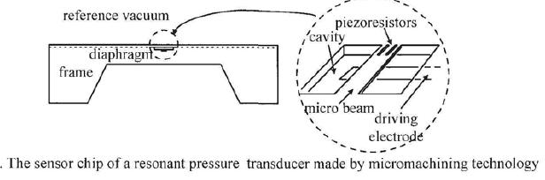

I am trying to model a simple resonant pressure sensor consisting of a rectangular beam suspended in the cavity formed on the top of the diaphragm. Pls refer to the figure in the attachment. Currently I am not so concerned with the beam excitation and want to only check the change in the resonant frequency of the beam with the pressure applied to the bottom of the diaphragm.

if it "stress stiffening" you are looking after, then in v3.5 you need to use matlab, to initiate a spatial solver, to stress your model, and then use that as a starting point for the egenvalue solver, as the latter linearizes the model.
in V4 you can link these sovler sequences as stated without the need for passing through matlab
Hi if it "stress stiffening" you are looking after, then in v3.5 you need to use matlab, to initiate a spatial solver, to stress your model, and then use that as a starting point for the egenvalue solver, as the latter linearizes the model. in V4 you can link these sovler sequences as stated without the need for passing through matlab -- Good luck Ivar
