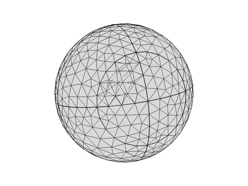

Posted: 1 decade ago 2012/07/27 6:54 GMT-4
It's so abnormal that the program gives such an error, since I have such 8 boundaries, but it gives an error about only one of them. Mesh looks like in the picture. It shows the problematic boundary.
how I created the geometry:
after creating two cylinders and one sphere, I intersected one cylinder one sphere with keeping input objects, so I created middle domains that are created by the intersection. Then I used delete entities to delete the remaining parts of the cylinder.
The result is one sphere with two caps at opposite ends.
physics undergrad
loves photon.
It's so abnormal that the program gives such an error, since I have such 8 boundaries, but it gives an error about only one of them. Mesh looks like in the picture. It shows the problematic boundary. how I created the geometry: after creating two cylinders and one sphere, I intersected one cylinder one sphere with keeping input objects, so I created middle domains that are created by the intersection. Then I used delete entities to delete the remaining parts of the cylinder. The result is one sphere with two caps at opposite ends. -- physics undergrad loves photon.
