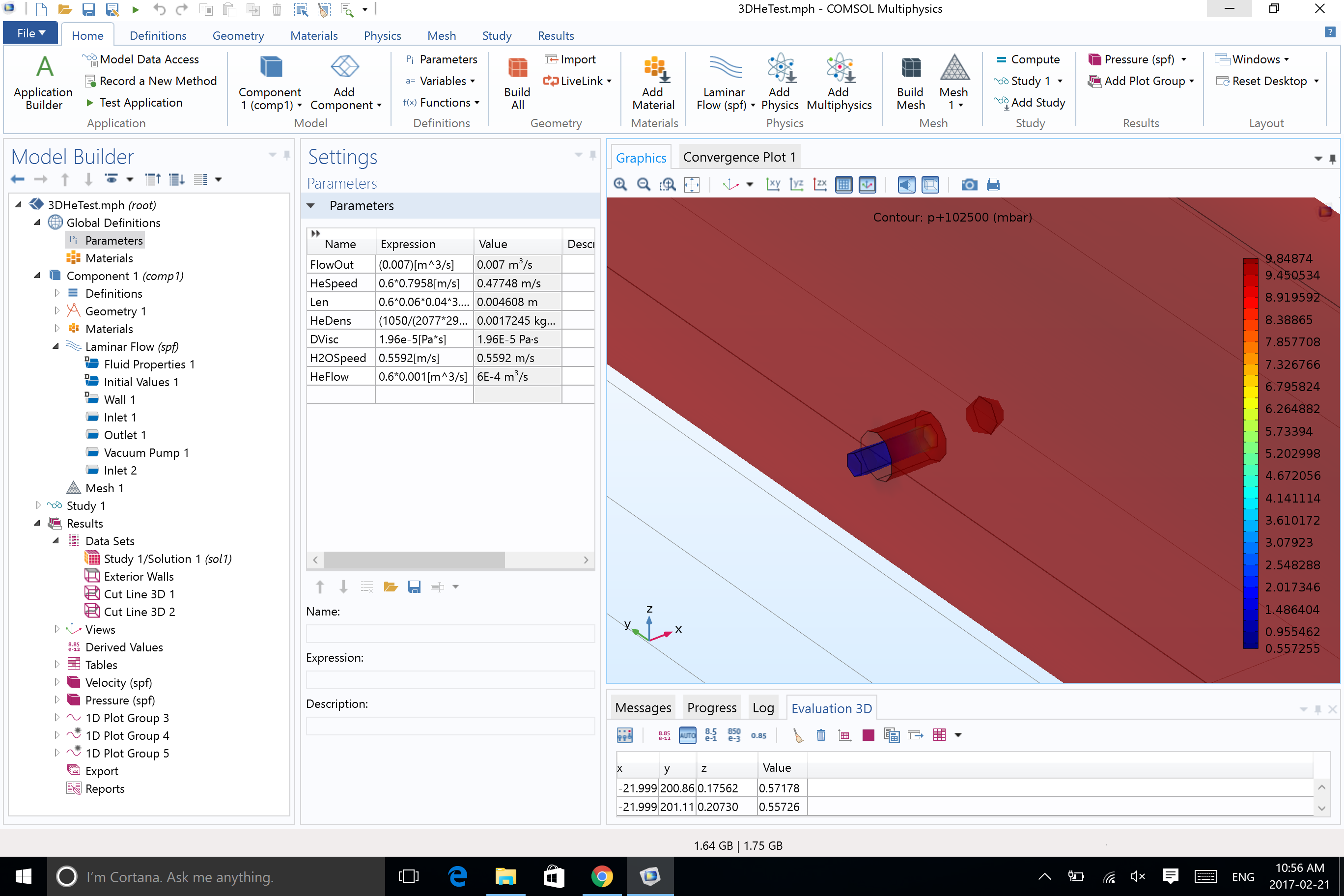

I am currently trying to model a cylindrical region in COMSOL (Laminar Flow Interface) that operates in the laminar flow regime. I am using one side of the cylinder to input Helium gas while simultaneously pumping on the other end. Half way down the cylinder is a pinhole that acts as an outlet. There is also a water drop in front of the pinhole which is intended to model a water droplet (the sample). I have set this drop as another inlet to simulate the evaporation rate. Finally, I set the outlet pressure to about 1 Pascal to simulate a region further down in the system (not part of the geometry).

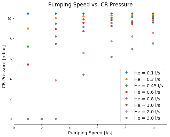

I have set the outlet pressure to the pressure that is expected in the next region (~1 Pa), but I have noticed that the pressure on that boundary never reaches that value once I run the simulation. I initially thought that this meant that the outlet pressure I set was too low and that the pressure shown was the lowest pressure attainable through that pinhole. But then when I kept all other parameters constant and lowered the outlet pressure again, the simulation computed a lower pressure on that same boundary but still not equal to the outlet pressure I set. Does anybody understand what might be going on here? Is COMSOL able to adjust boundary conditions?
My biggest issue is how to interpret the change in pressure when I change certain parameters. The pressure tends to move in the opposite direction than I would have thought. For instance, when I increase the flow through the top inlet, the average pressure seems to go down. And when I increase the vacuum pump flow rate, the average pressure goes up. I may be misunderstanding something (and likely have something set up incorrectly) but isn't this counter intuitive? Shouldn't the pressure increase if the flow in is higher and the flow out is lower?

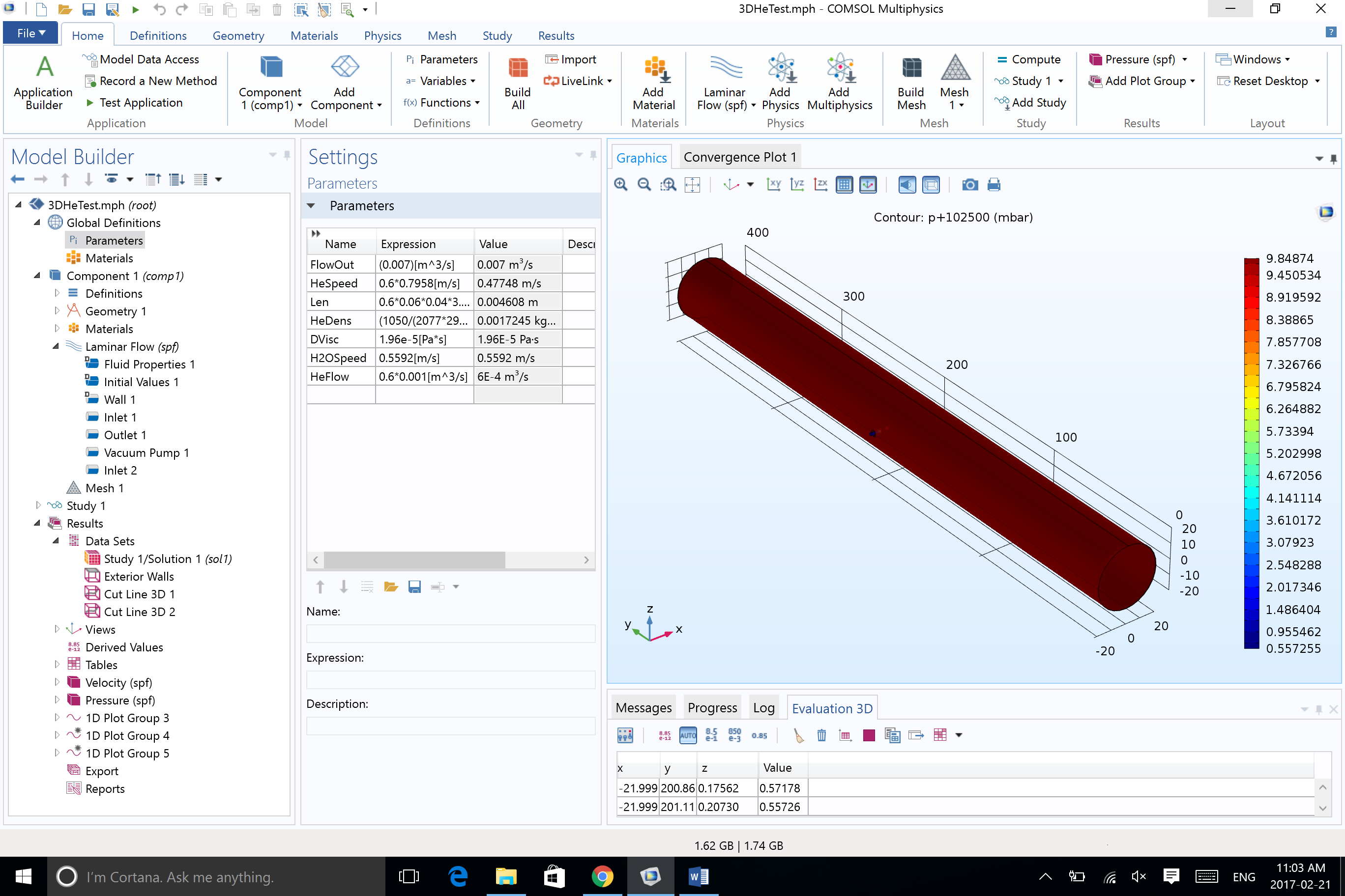

I forgot to add some pictures so I have attached them to this post.

I do believe there is still something wrong with my settings since the trend I am observing does not make any sense. When I increase the flow in through the inlet, the pressure goes down. And when I increase the free delivery flow rate, the pressure goes up.
(I am treating the free delivery flow rate as a variable in order to determine which pump I will need to order)
