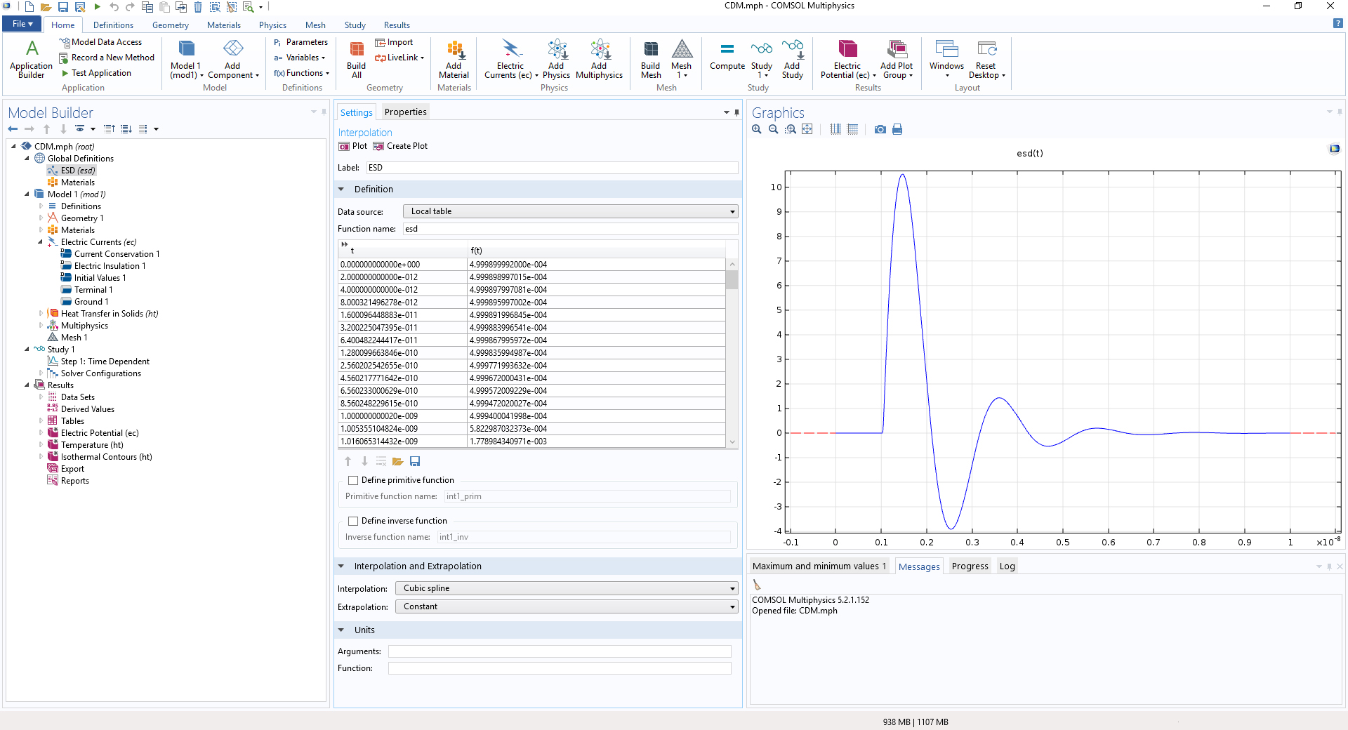

HELP ! can i set the current input with this file ?

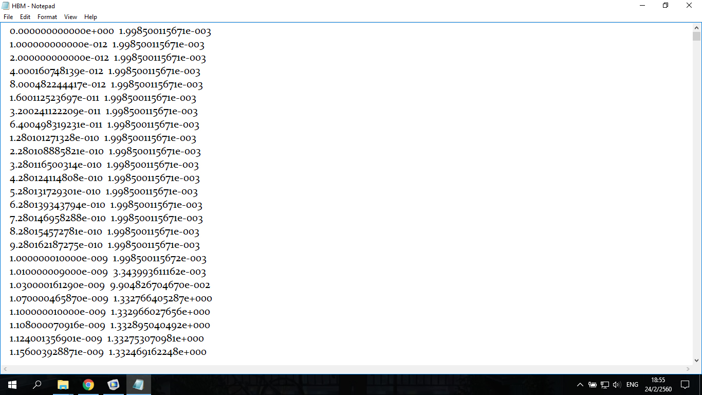

i have .txt file and , in the 1st column is the time, and the 2nd column is the Current , can i use this .txt file into this model . and see the temperature

Yes. You can use an Interpolation Function (under Definitions in the model tree). It should be pretty self explanatory, but you can also read up on it in the Reference Manual for COMSOL Multiphysics, version 5.2a, page 277 and following, or search the Discussion Forum for "Interpolation Function".
Yes. You can use an Interpolation Function (under Definitions in the model tree). It should be pretty self explanatory, but you can also read up on it in the Reference Manual for COMSOL Multiphysics, version 5.2a, page 277 and following, or search the Discussion Forum for "Interpolation Function". Best, Jeff

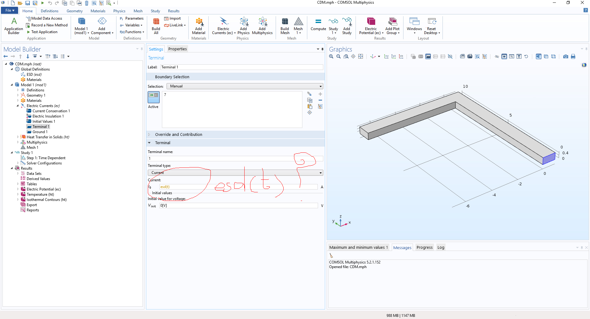

now i can import Interpolation Function in 1st picture right? and then i put the function in the Current input in 2nd picture right ?
Hi, Jeff Thank for the answer. now i can import Interpolation Function in 1st picture right? and then i put the function in the Current input in 2nd picture right ?
