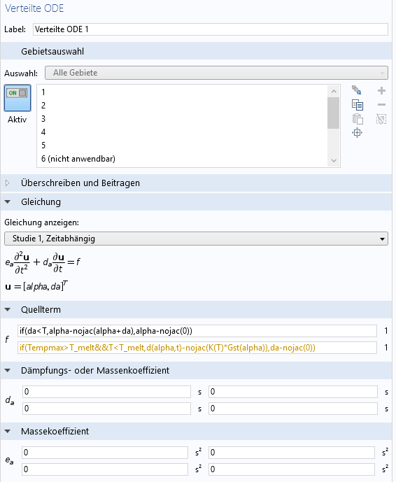

So i tried to set up an ODE node in my model which should calculate alpha for the mentioned boundaries. The MaxTemperature (tracked through the Temperatur history) is also calculate in a seperate ODE and will be used in the ODE to set one boundary condition in the alpha ODE:
if(TempHistory>T_melt&&T<T_melt,d(da,t)-nojac(K(T)*G(alpha),da-nojac(0)
if(da<T_melt,alpha-nojac(alpha),alpha-nojac(0))
--->TempHistory=max Temp over the history; da=differential value alpha per timestep; T_melt=melting-Temperatur

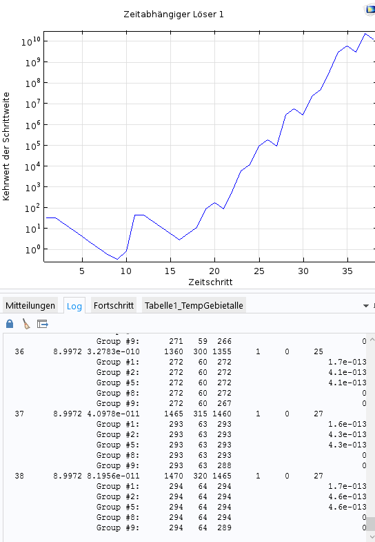

For a better understanding i attached a screenshot.
Now i have been searching for my mistake for one week now. I would be happy about any hints, ideas why this doesn't work! am i doing something wrong?
