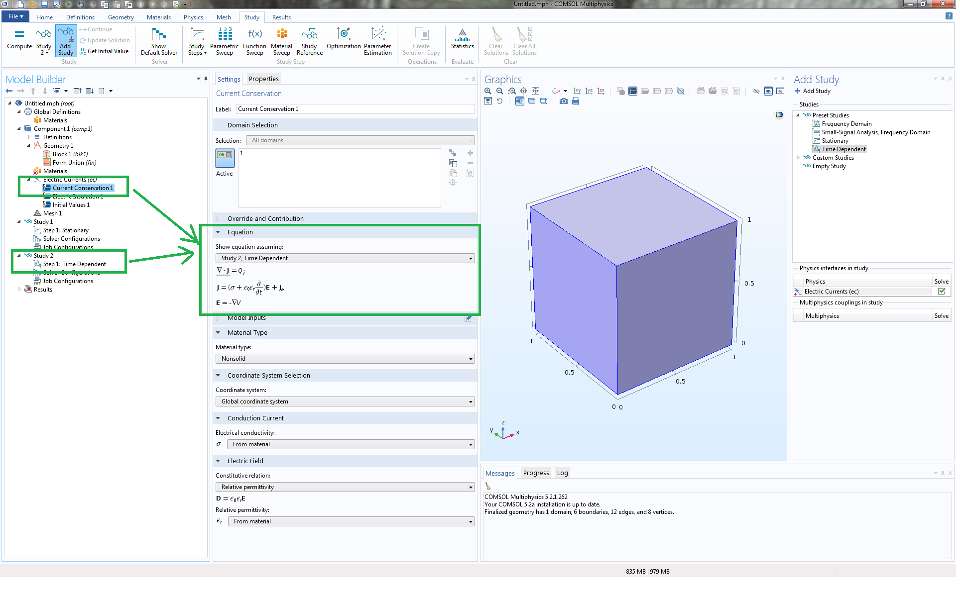

As long as you plan on solving the Electric Currents in a stationary way, only the conductivity is needed. The relative permittivity is needed when you do a time-dependent study, see attached screenshot.
Hello Carmen, As long as you plan on solving the Electric Currents in a stationary way, only the conductivity is needed. The relative permittivity is needed when you do a time-dependent study, see attached screenshot. Best, Jeff
