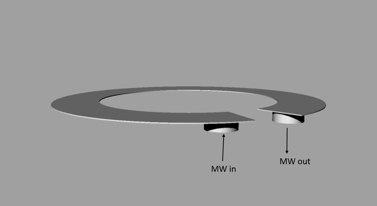

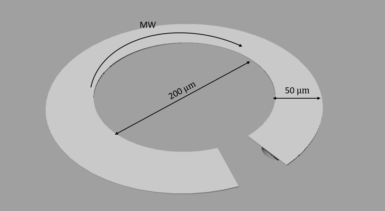

Hello, I hope you are having a good day.
I have included two images of the geometry I would like to simulate. I would like to know the field distribution inside the ring and as a function of z. I am worried about coupling between the input and exit ports of the structure. Also if I could get the impedance of the ring at 3 GHZ so I can make some compensating structures that would also be appreciated.
Ultimately, I would like to simulate many structures and then optimize their parameters given certain conditions.
Any help would be appreciated.
Hello, I hope you are having a good day. I have included two images of the geometry I would like to simulate. I would like to know the field distribution inside the ring and as a function of z. I am worried about coupling between the input and exit ports of the structure. Also if I could get the impedance of the ring at 3 GHZ so I can make some compensating structures that would also be appreciated. Ultimately, I would like to simulate many structures and then optimize their parameters given certain conditions. Any help would be appreciated.

I suggest you analyze that structure using the AC/DC module, since it is small on an RF scale. You can do a sanity check on your results using analytic expressions for a simple current ring. See hyperphysics.phy-astr.gsu.edu/hbase/magnetic/curloo.html , among others.
I suggest you analyze that structure using the AC/DC module, since it is small on an RF scale. You can do a sanity check on your results using analytic expressions for a simple current ring. See http://hyperphysics.phy-astr.gsu.edu/hbase/magnetic/curloo.html , among others.
