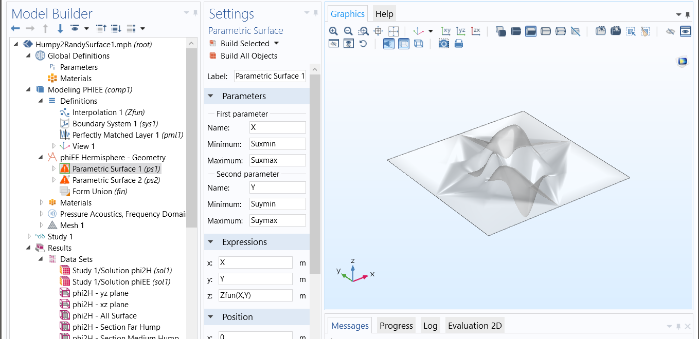

I have a unique 3D random (random points) surface generated. Am trying to import this data points into Comsol. This convert the points into a surface and then into a solid by extruding the surface. Thank you.

If I understand what you want to do correctly, you could use an Interpolation function and a Parametric Surface based on that function. What I have in mind is similar to www.comsol.com/support/knowledgebase/838/
but you'd be using an Interpolation function where the example above uses an Elevation (DEM) function.

Thank you. It did work but the shape of the surface is not exact.

Okay. I will do that. Find attached what Am talking about..
Actual Surface: is the actual figure
Surface after using the Parametric Surface: This is what I see after using the Parametric Surface.
Hello Jeff, Okay. I will do that. Find attached what Am talking about.. Actual Surface: is the actual figure Surface after using the Parametric Surface: This is what I see after using the Parametric Surface.

Have you tried increasing the number of knots that are used to make the parametric surface?
Hi Daniel, Have you tried increasing the number of knots that are used to make the parametric surface? Jeff

I did try to increase the number of knots. However, It's still the same.
