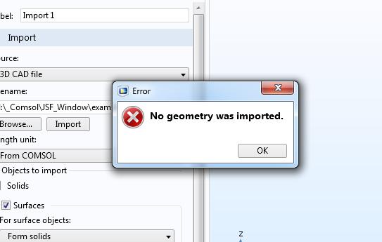

Can anybody explain how I can import some flat panel polygons I have defined as a series of x, y, z position vectors in ASCII into a Comsol file geometry.
I have used Matlab to create some CAD dfx files and tried doing an import. Everything looks like it is going fine then just get a "no geometry imported" error message. (See attached screenshot)

From the error message it seems that you have not selected the check box for importing Curves and points in the Settings window for the Import feature.
Another approach, which will not require a CAD format such as DXF, would be to export the point coordinates to a text file, and in the COMSOL Multiphysics model use the Polygon feature with the Data source set to File.

Posted: 8 years ago 2017/03/24 19:24 JST
That seems to have done the trick, never would have spotted that without your help.
