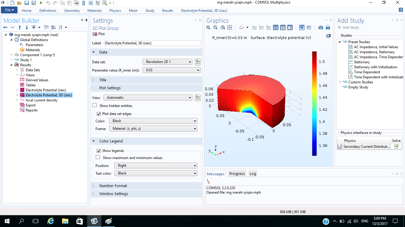

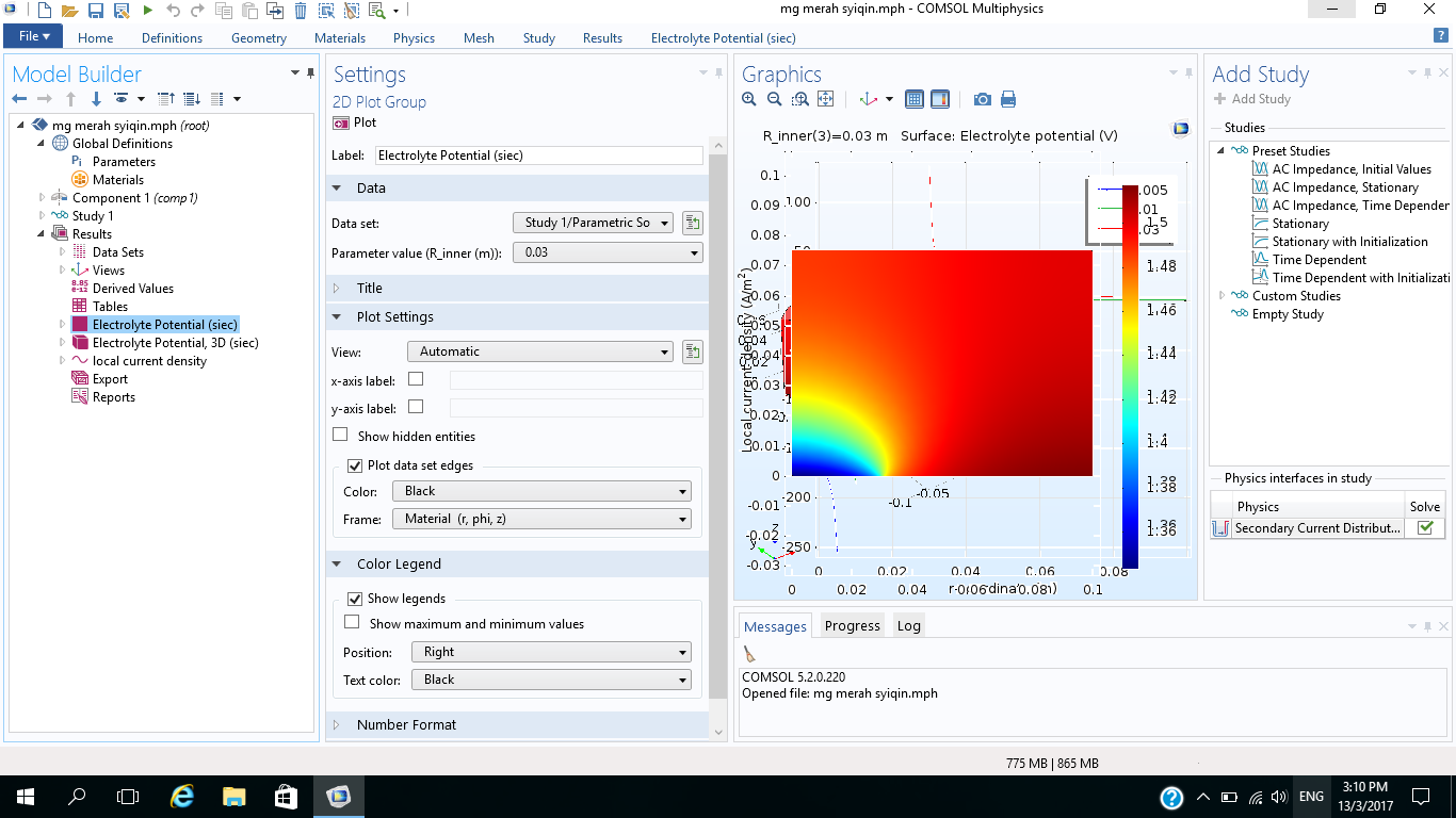

Graphis Display Overlap
How to fix this

Farkhan-
I would try using "Reset Desktop" from the Home Ribbon.
Or, if this doesn't work, under File>Preferences under "Graphics and Plot Windows" change the Visualization> Rendering to "Software" instead of OpenGL. Or, you may try "Optimize for:" Performance instead of Quality.
Josh Thomas
AltaSim Technologies
Farkhan- I would try using "Reset Desktop" from the Home Ribbon. Or, if this doesn't work, under File>Preferences under "Graphics and Plot Windows" change the Visualization> Rendering to "Software" instead of OpenGL. Or, you may try "Optimize for:" Performance instead of Quality. -- Best regards, Josh Thomas AltaSim Technologies
