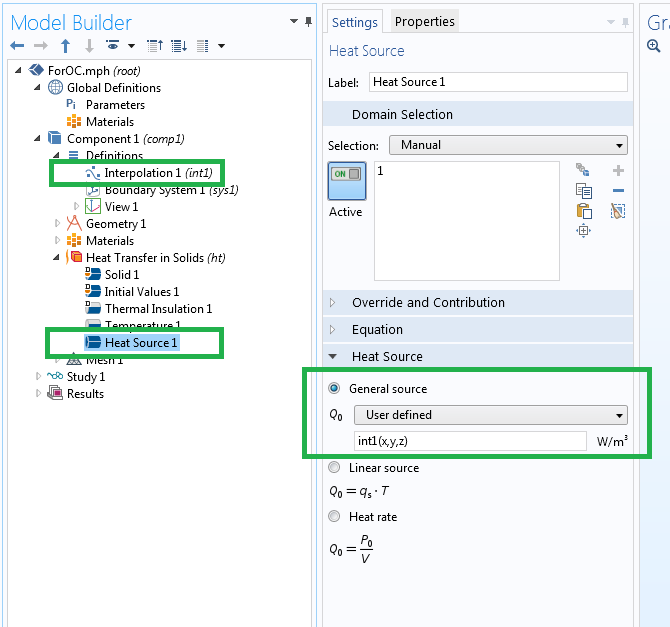

Posted: 8 years ago 2017/03/30 22:53 GMT-4
Hi Jeff, Thanks for your help and apologies again for asking.
My question is I do not know how to call the int function that is in position 1. This int function is the heat generated. But in heat transfer, what can I do to call the function in the heat source (Q)?
Now I do not know how to call the x, y, z coordinates. I do not know if it can be explained me with an image or an example. Thank you very much and sorry again.
Hi Jeff, Thanks for your help and apologies again for asking. My question is I do not know how to call the int function that is in position 1. This int function is the heat generated. But in heat transfer, what can I do to call the function in the heat source (Q)? Now I do not know how to call the x, y, z coordinates. I do not know if it can be explained me with an image or an example. Thank you very much and sorry again.
Jeff Hiller COMSOL Employee
Posted: 8 years ago 2017/03/31 8:27 GMT-4
See the attached screenshot.
PS: I encourage you to work through the Introduction to COMSOL Multiphysics manual (Accessed through File > Help > Documentation). It will save you a lot of time compared to trying to figure things out by yourself. The Applications Libraries are also full of tutorials with step-by-step instruction that you can use for self teaching.
See the attached screenshot. Best, Jeff PS: I encourage you to work through the Introduction to COMSOL Multiphysics manual (Accessed through File > Help > Documentation). It will save you a lot of time compared to trying to figure things out by yourself. The Applications Libraries are also full of tutorials with step-by-step instruction that you can use for self teaching.
Posted: 8 years ago 2017/03/31 13:41 GMT-4
Hello Jeff.
Thanks for your help. I was missing the units. In Heat Source it is int1 (x [1 / cm], and [1 / cm], z [1 / cm]). This was my mistake. But thanks to you, you were a great help.
Cordially
Oriana
