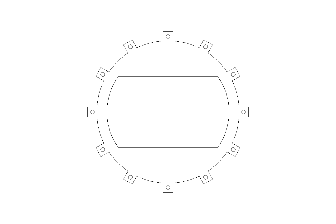

Hello Ivar
Im trying to simulate a smiple rotating machine but I have problems with the restulted magnetic fields they are not moving in the right way please see the attchment
You can download my modell through the following link
www.dropbox.com/s/d8pns2qtnrjnaxk/drehstrom_2.mph
Thanks in Advance
