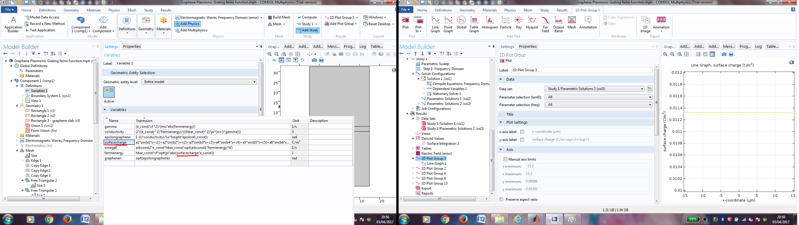

Hi! I'm using comsol 5.2a. I've found a function for results from another comsol file, and I'd like to use that function to describe it in another file in order to save file size and computational time.
I've defined it as a variable with lots of parameters associated, as shown in the screenshot. I went to check that it was working correctly but unfortunately comsol believes the function is actually a constant - the value of the function at it's maximum (x=0). What's going on here?

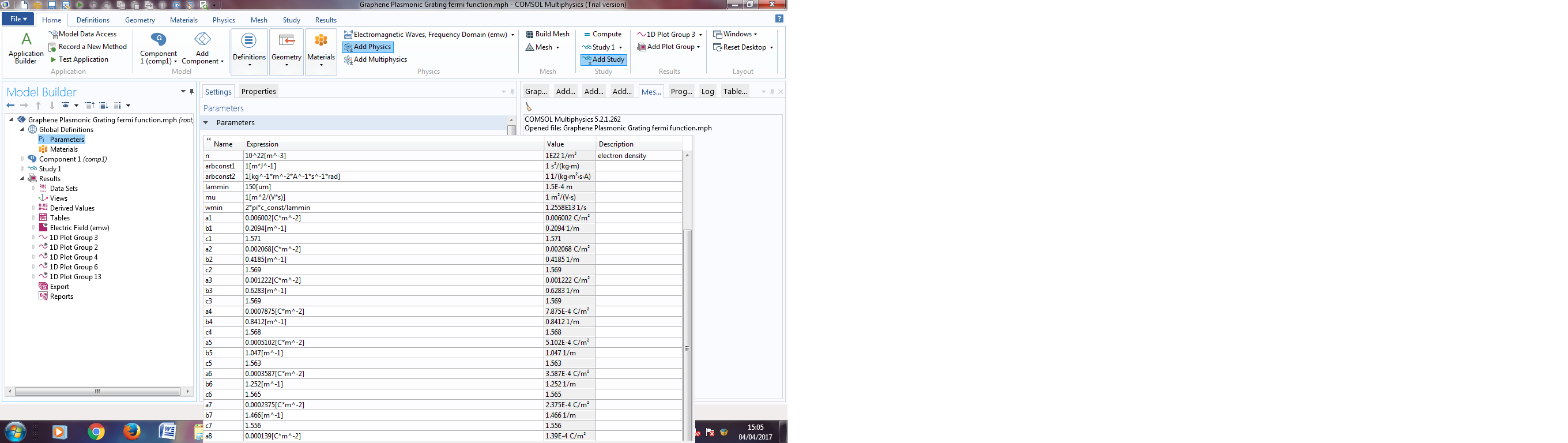

Hi Mohammad, thanks for the response. I've screencapped the relevent part of the parameters list for you in parameters.png. The parameters are non-zero. The a parameters have units of surface charge density, the b parameters have inverse spatial units so to cancel b*x to be unitless, which is compatible with the c parameters which are also unitless.
I also changed the variable to "surfacechargerrr" with the plot also changed, just in case comsol reserves the string "surfacecharge", but it still displays the same thing.
