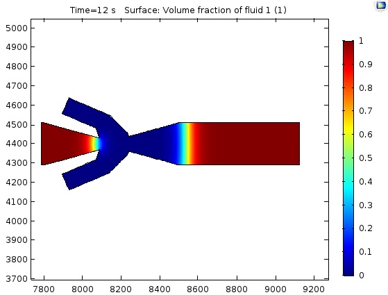

Dear COMSOL users,
I am trying to simulate the formation of water-in-oil droplets in a plannar flow focusing geometry.
The physics I am using is the laminar flow-phase field.
The boundary conditions for the inlets are the flow rates that I used experimentally.
The simulation "runs" "properly" only when the option Neglect surface tension in momentum equation is activated.
Once I activate this option, the computation process takes ages ( stuck at 4%) and eventually crashes.
I would appreciate if you could provide any advice related with this issue. I am confident it is just a small but critical mistake in the settings of the model.

Thank you for your reply. Unfortunately the simulation gives the following error:
"The following feature has encountered a problem:
Undefined value found.
NaN or Inf found when solving liner system using SOR.
- Feature: Time-Dependent Solver 1 (sol1/t1)"
The mesh is indeed quite messy, but I think the problem comes from another source.
Dear Amin, Thank you for your reply. Unfortunately the simulation gives the following error: "The following feature has encountered a problem: Failed to find consistent initial values. Undefined value found. NaN or Inf found when solving liner system using SOR. Last time step is not converged. - Feature: Time-Dependent Solver 1 (sol1/t1)" The mesh is indeed quite messy, but I think the problem comes from another source.

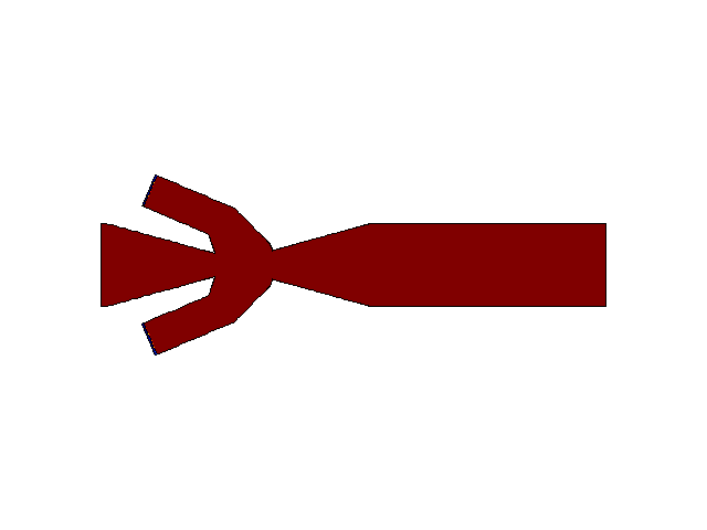

Victor,
I made a few minor changes to the file you attached and it is working now.
My changes:
1) Remeshed the geometry.
2) Changed all the inlet entrances from 1m (default value) to 0.1 mm. Your domain size is in the order of mm and the inlet entrance of 1 m is physically inappropriate .
See the attached files.
