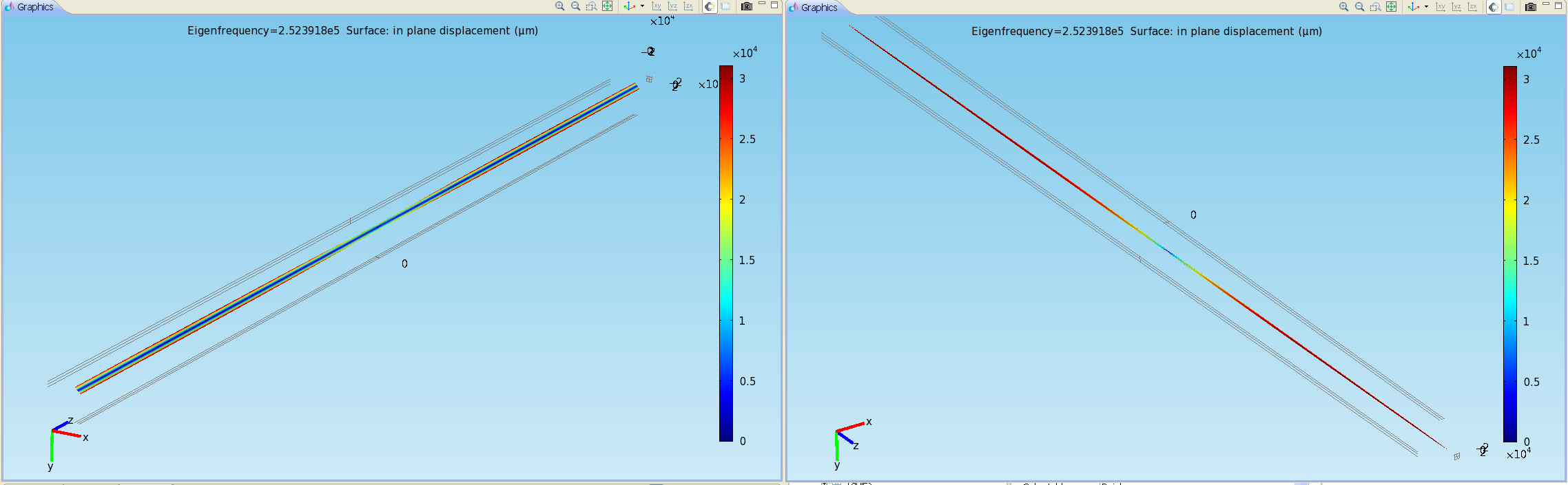

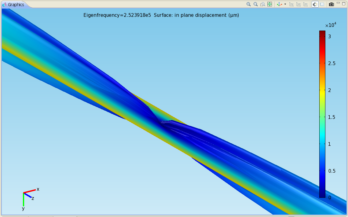

I wanted to attach images of what I mean when I say "two large needles." I know, this is super weird, I wish I understood what I'm looking at.
Posted: 1 decade ago 2011/02/18 6:02 JST
Well I'm sorry to hear that you have only 4.0a as that was provided more than a year ago, and you definitively need to get the 4.1 + patches (the latter are on the main web site of COMSOL. Be aware v4.0 was an early version with several weakness
I believe the eigenvalue "participation mass" arrived only in v4.1 (so you would have to live without, for the time being)
Then for the frames, its the opposite: the spatial frame is on by default in V4 and it is the deformed frame. The material frame is the original one of the drawn geometry (by default its plotted as a wire frame on all surface/volume plots. To access the material frame you use upper case letters X,Y,Z and spatial has lower case letters. Your solution is normally in the material frame, so if you do a postprocessing (Results node) integration, you do it on the solution defined frame. While if you define an integration operator in the Definition right click Model coupling you can chose the frame to operate on. You can then use the Results Derived Values Global Evaluation to perform an integration with the previously defined integration operator that will distinguish the two frame values, if you define two operators one on each frame (hope its clear)

Wow! Great tutorial. Yes I didn't understand that "operator" does not mean "quantity," though that should have been clear from the term.
I did your tutorial and also integrated around one of the edges of the cube for both Material and Spatial frames, to make sure I could see a difference, and it worked and the units were correct.
Yet I am still seeing a very strange thing when I try to do the exact same thing on my model (i.e. integrate around an edge to find the perimeter length).
Expected: The integral around the edge for the material frame for a 100um diameter silica disk is 314um as expected.
Unusual: The integral around the edge for my spatial frame (everything else the same as before) is different for each mode, as expected, but the numbers are on the order of 1e7 um! (On the order of ten meters!) I would expect something slightly different to 314um.
Sorry for all the bizarre questions... I really appreciate you helping me with this.
I tried to attach my v4.0a file, but this site said "File size error" -- the file is 6.4 MB which I didn't think was that large, but whatever. So my file is here:
davidnhutch.com/3dDiskMechModes.zip
Note also that I don't think this is related but I am getting Warnings: The relative error is greater than the relative tolerance." I would make my mesh smaller to see if it fixes this but I run out of memory..
