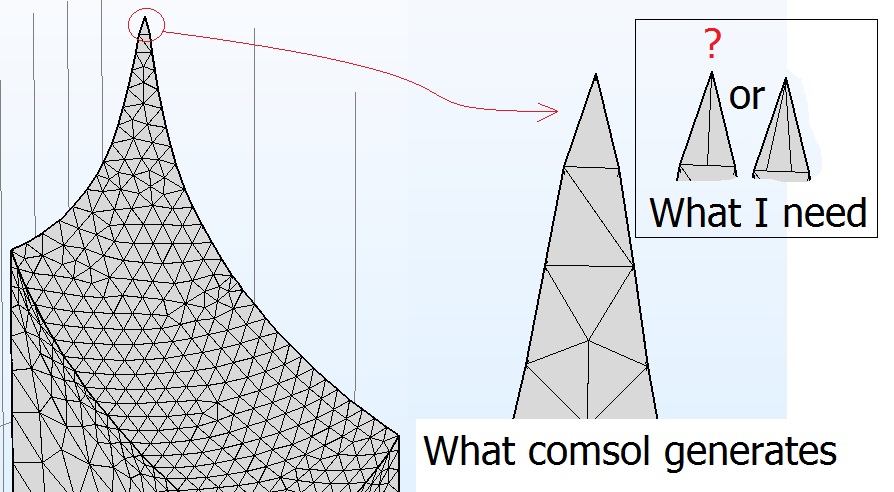

Can anyone help me get my desired mesh in the corner of the curved surface found in the attachment?
This is a 3D model and I used tetrahedral meshes. As I decrease the mesh size, I still get one element in the corner. I need to get two or more.
Is there any way to do this?

You could perhaps use partitioning of the geometry to force the elements to be as you would like. Maybe use the point in the corner as one of three points to define the workplane to split your part.

Attached is mesh with controlled number of elements in the corner.

Thank you for your replies. It worked.
